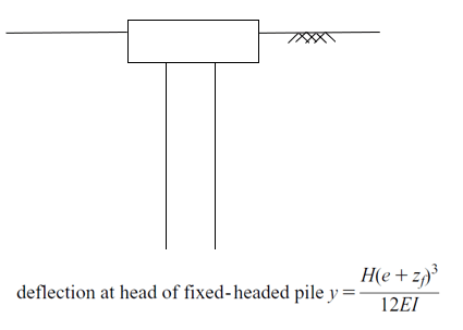

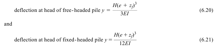

I was using the method in Tomlinson & Woodard publication to estimate the lateral deflection of a pile with a pilecap on top.
Firstly, I presume equation 6.21 applies, for a fixed head rather than a free head. I thought perhaps a fixed head may be for a pile within a pile group.
Has anyone seen empirical methods for calculating deflection if pilecap is semi submerged into the soil?

- It is true that equation 6.21 is for deflection at head of fixed-headed pile..
- Fixed head may develop at a pile within a pile group with rigid pile cap but the pile would be deep and flexible .
Refer to Figure 6.30 ( Coefficients for calculating deflection of pile carrying both moment and lateral load )
Pls notice that Mt/(HT)= −0.93 for fixed-headed case and Mt/(HT)= 0 for free -headed case. You will see in-between cases where ,Mt/(HT) is (-0.1,-0.2,-0.3...-0.7..) as usual ..

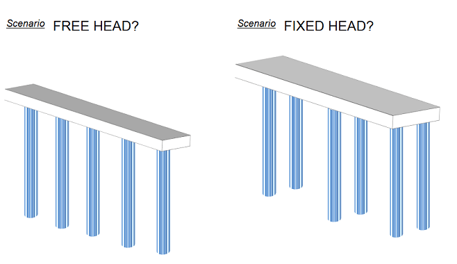

EZBuilding, I agree that for a single pilecap, the pilecap being semi submerged, wouldn't make much of a difference to the deflection. But for a continuous pilecap, I thought it may be more significant. It's more of a question of what's normally accepted practice. Then again, the top portion seems to be ignored by some, in for example stability calculations.
If the pilecap is continuous along a single row of piles, I presume this is still a "free head" scenario. And for two rows of piles, this tends toward "fixed head".
HTURKAK, Figure 6.30 will be helpful actually.

Then modell the pilecap ( together with the piles ) with FEM etc and see how fixity develops..
The left picture, free head at short dir. loading and fixed ( or probably partial fixity develops ) at long direction ..
RE: Lateral deflection of a pile with pilecap
This is my understanding on "fixed head" vs "free head" piles. I think Lpile can provide information on the deflection and slope of the shaft.
