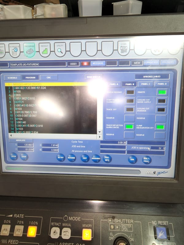

Hello, Need help with laser paper issue. I just bought an old 4000w CO2 Amada FO3015 and I cant find any information or settings to preburn the protective vinyl film along the cut path. The material we need to run is 18ga 201 stainless and removing the vinyl film is not an option for us. We have tried running the material upside down but that leaves an unacceptable edge. Anyone have settings they use for this machine to preburn the protective film?

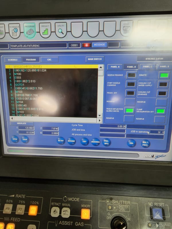

Try changing all the:
M103
To M133 M134 or M135.
It's been a long time. I'm not sure I'm getting that right. Try it and see what happens.
Thank you laserninja. I believe you are dead on but our machine is a few years older and only has the 101, 102, & 103 for a pierce. We will be trying some etch settings in the next day or two. Ill post the results when we do.
Trust me.
Even though it's not listed in the cutting condition, I may work.

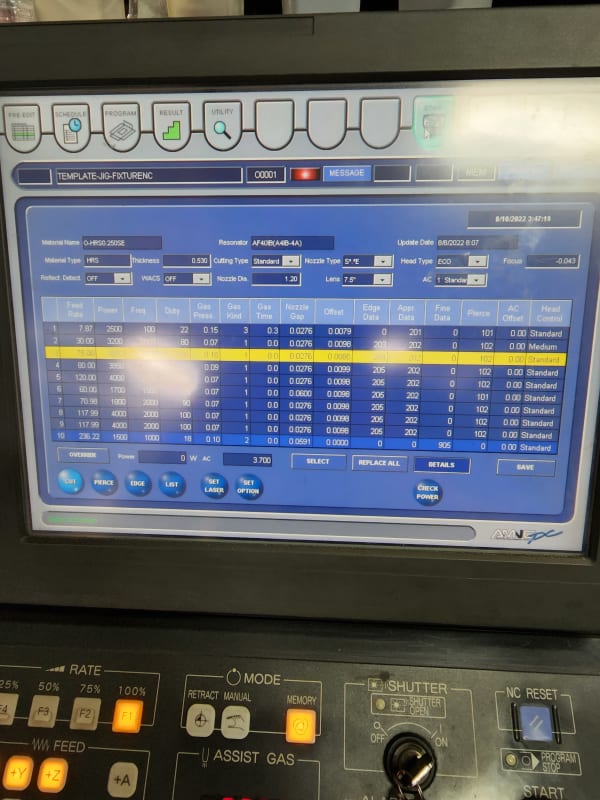

usually premelt is E9 around 300 ipm 1500 watts 1000 hz 32 duty with a noozle gap of 3mm
Thanks guys, we found a setting we liked and ran with the 1500 watts 1000 hz and duty at 25. That produced the cleanest edge on the vinyl.
The vinyl just barely started to burn/spark at a duty of 20 on our machine and going up to 35 duty really gave a rough distorted edge to the vinyl that was on this material.

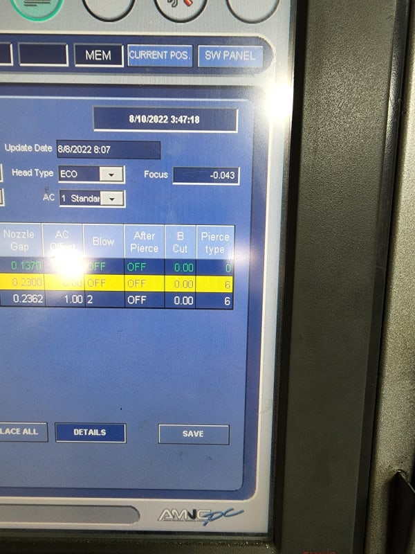

Try this, On the screen click on where it says Condition on the upper right hand corner,
Once your in the condition box, look for where it says pierce on the bottom left corner.
When you have pressed pierce, now look where it says pierce type on there you will see a number, click on it and type 135 for all 3 of the boxes. then hit save.
That will create a pierce spit from above before it touches the sheet and problem solved. Hope that helps.
