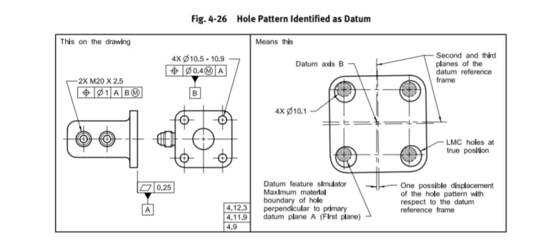

2. Myself and a coworker are curious about using a hole pattern as a datum. I say that it can be done (I showed him my textbook and that it does satisfy our design intent), but he says that he doesn't understand what a hole pattern datum actually is so he doesn't want to use it. Now I am curious - how should an inspector interpret a hole pattern that is called out as a datum?
Say for example that the hole pattern is called out as datum E. Is there a datum axis E that goes through each hole in the pattern? Or does a single axis go through the middle of the entire pattern? What if some holes are not straight/true to one another within the pattern?
I also want to treat the holes in the pattern as RFS. Will a hole pattern datum still work at RFS?

Regarding your question no. 2,
Generally, datums are used in order to establish a datum reference frame - 3 mutually perpendicular planes defining an origin to relate the geometry to. The measurement coordinate system is either the simulated datum reference frame or it is based on it (with some fixed translation and rotation). With a pattern of holes, you want to achieve the same outcome, while the datum itself is just to give you something to base your datum reference frame on. Typically a pattern of parallel offset holes will provide a datum axis at the center of symmetry of the true positions of the holes in the pattern (if such exists). The true positions will also be used to orient the datum reference frame planes. The image below is an example from the ASME Y14.5 standard of a datum axis derived from the datum feature simulators of a pattern of holes referenced at MMB. The difference for an RMB datum reference would be that instead of being able to use a gage with fixed size pins as datum feature simulators, you would need a group of simultaneously expanding pins.
