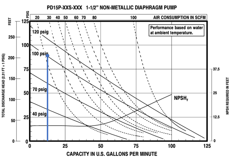

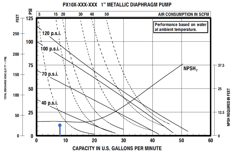

Admittedly, I am not familiar with minimum flow requirements for diaphragm pumps. I did not see any listed on the spec sheets.
Below are the pump curves and my duty points.
