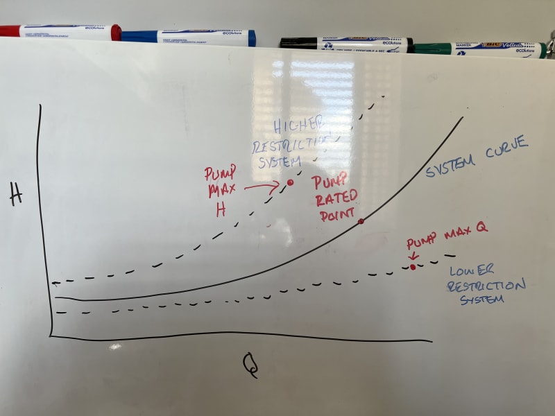

Sorry to interrupt you all again. Today I checked my pump name plate it has Q (rated) = 180 m3/hr
Max 284 m3/hr.
Same as head (rated) 45 Mtr but max 65 MTR.
What does it mean ? If anyone have seen this picture please explain me a Little bit.
I attached the nameplate image.
 https://files.engineering.com/getfile.aspx?folder=fb38f4a3-61b2-4f2f-b0c4-ea7eb6082905&file=IMG_20240224_145907.jpg
The data on the plate shows that the rated flow and head are 180 cubic metres per hour and 45m, respectively.
The max figures are the flow and head that the pump can reach, but not at the same time.
If the head goes up, the flow comes down and likewise, if the flow goes up, the head comes down. The performance details will also tell you the BEP, best efficiency point for the pump. The BEP should be at the rated point for the pump. So 80% efficiency at Q=180 and H=45. If you run the pump with flow and pressure away from the BEP, the efficiency will be less than 80%.

Those numbers could be two things.
1, the max flow and head available with the biggest impellor that will fit in that pump.
Or
2 The max flow at the end of the curve. So the head would be lower than 45.
Maxhead is probably no flow / shut in head.
If the resistance to flow in your system is lower than 45m at 180 m3/ hr then the flow will increase until the frictional l and other losses equa, the head out out by the pump.
This could be because of bigger pipe, shorter ,length, less valves a d other fittings than calculated, opening up control valves, less resistance to flow in any item
As mentioned before a centrifugal pump will change its output depending on the conditions placed in the discharge line.
The pump rating for H and Q are at the best efficiency point.
If you add more restrictions in the line, the pressure will go up, but the flow will be lower. Likewise, if you reduce the restriction in the line, the pressure will go down and flow will increase.
The max values on the pump plate are telling you the max that the pump will do, irrespective of how low or high the system’s restriction is.
The chart is very useful, but max head will be at zero flow in most instances.
The point marked pump max head is just higher than the rated head. IMHO.

FluidPowerUser sir If you add more restrictions in the line, the pressure will go up, but the flow will be lower. Likewise, if you reduce the restriction in the line, the pressure will go down and flow will increase.
So I must have reduce the restrictions in my piping (straight pipe without any bends or fitting etc) to get more flow even if I want to get that Max flow rate, yes it is achievable.
I can’t agree with that point, but I’m not being argumentative.
We don’t know if the impeller is unshrouded, single shrouded or double shrouded. Also, the volute is designed around the impeller to match the head and flow performance. If you change the impeller in the volute, the performance of the pump will change dramatically. It’s the OD of the impeller that determines the pressure that the pump can produce as the flow is generated by the vanes of the impeller and the fluid is flung outwards and collected in the volute.
Zero flow on a centrifugal pump will result in zero pressure as pressure is simply the resistance of flow. It will also not cool the pump seal, so what would be the point of having an unachievable performance point on the plate?
That’s just my opinion based on experience of pump design.
I did say most pumps but shut in head/ no flow is not zero head. There is internal re circulation. It is normally the highest pressure the pump will generate.
Shut in head is quoted to make sure the piping etc can withstand the pressure if the flow is stopped/ valve closed somewhere downstream.
