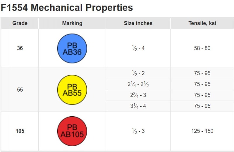

dik said:
Their (A307) UTS is 60 ksi and F1554 is higher.
How much higher? Compared to F1554 grade 36.
F1554 is an ASTM specification for cast in place anchor bolts. It was established to clarify material properties for anchor rods used in concrete. Prior to it’s creation, concrete anchor bolts were most commonly specified using the generic round bar specification A36 or the headed hex bolt specification A307. The F1554 specification also qualifies two grades in addition to grade 36, grade 55 & grade 105.
As attached:
75Ksi... I don't know what Grade 36 is, but the cost difference between the two grades is almost nothing.
For 36grade the lowest UTS is 58Ksi... I looked it up...
I always spec Grade 55S1 so it's weldable... I've not used Grade 105. Even if Grade 36 is spec'd I stipulate the fabricator use Grade 55 with the EOR's approval... the added strength is almost free.
