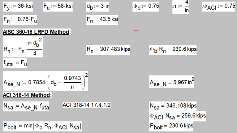

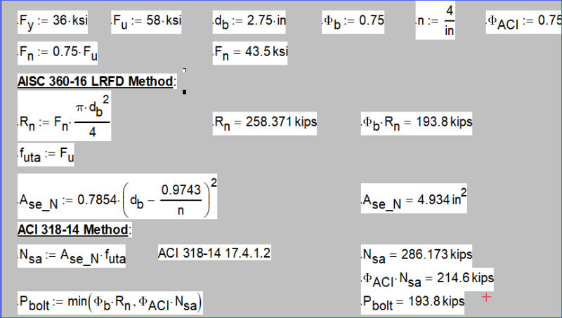

HTURKAK:
Thanks Rabbit, I hadn't considered that.
I have read through the thread and here is what I came up, for 2 3/4" diameter and 3" diameter:
For 2 3/4" Diameter F1554 Grade 36 Anchor Rods:
For 3" diameter F1554 Grade 36 Anchor Rods:
The capacities for the 3" diameter F1554 Grade 36 Anchor Rods agrees with this thread:
thread507-459508: Different Anchor Rod Tensile Strength between ACI 318 method and AISC method:

The result from LRFD methods corresponded well with the result from ASD, 194/118 = 1.64.

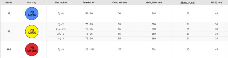

Elongation of F1554 is better than A307...
That's been my experience... $5 per rod... If you need the anchorage to yield at a lower strength, you can likely reduce the diameter by 1/2"...
dik,
Not to argue which is better, but mind you that the grade should be indicated when specifying F1554.
Always... and I spec Grade 55S1 all the time... I want it weldable, too.

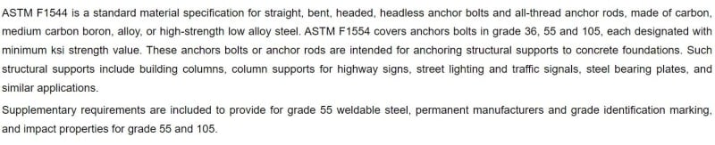

Apparently this snap taken from the web ,
Probably it would be better to look the scope of the Standard Specification for Anchor Bolts, Steel, 36, 55, and 105-ksi Yield Strength ASTM F1554 ..
1. Scope*
1.1 This specification covers straight and bent, headed and headless, carbon, carbon boron, alloy, or high-strength lowalloy
steel anchor bolts (also known as anchor rods). The anchor bolts are furnished in three strength grades, two thread
classes, and in the sizes specified in Section 4......

HTURKAK... I was going by the contents of the specification... it seems to be somewhat material related, including chemistry...
