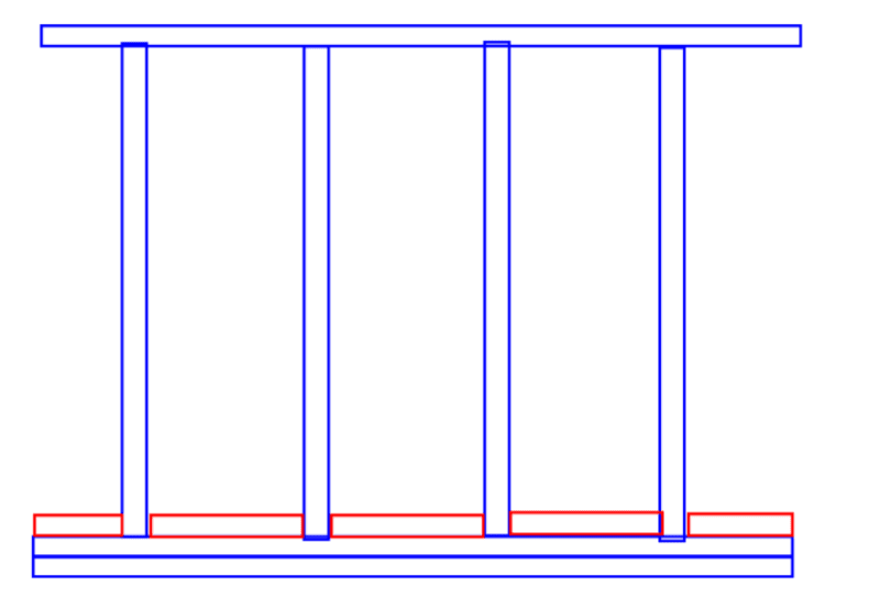

Has anyone ever specified sheetrock shearwalls? I'm curious about the connection to the bottom plate.
Around here, 8 ft. walls use 93" studs and three plates for a total of 97 1/2". Assuming they hang the ceiling first, that leaves 97" of wall for 96" of sheetrock - so only 1/2" of lap on the bottom plate. Assuming they locate the screws perfectly, it allows 1/4" of wood and gypsum edge distance for the screw. I noticed on my new house construction that they did not even bother fastening the sheetrock to the bottom plate - likely for this reason. Fortunately, I am not counting on the sheetrock for lateral.

1) I've been assuming 92.625" for precut studs which gets your over lap to at least 7/8".
2) If one wanted to build these walls special, what would be the best way? One option below that will, of course, still ruffle feathers and raise eyebrows.
Precut "stud length" studs should be 92.625" once the additional 4.5" of plates are added it equals 97.125". The intent there is you should be using 5/8" ceiling drywall to prevent sagging between joists/trusses, and it should be installed first, leaving 96.5" of wall to cover. Fits an 8 foot sheet almost perfectly and you have at least about an inch of coverage at the bottom.
The trick, is getting them to screw the bottom of the sheets, because in my experience, last screw on the sheet is about 3" off the sheathing on the stud line.

For sure. Although my trim guy was happy about that as it makes it easy for him to find the studs for baseboard since the sheetrocker did not mud the bottom screws.
One one level, I kind of feel as though gypsum shear walls are so sketchy to begin with that maybe it doesn't matter so much if the fasteners don't make it to the plates. That said, I'm also not willing to be the one to go rogue on the usual detailing requirements.
