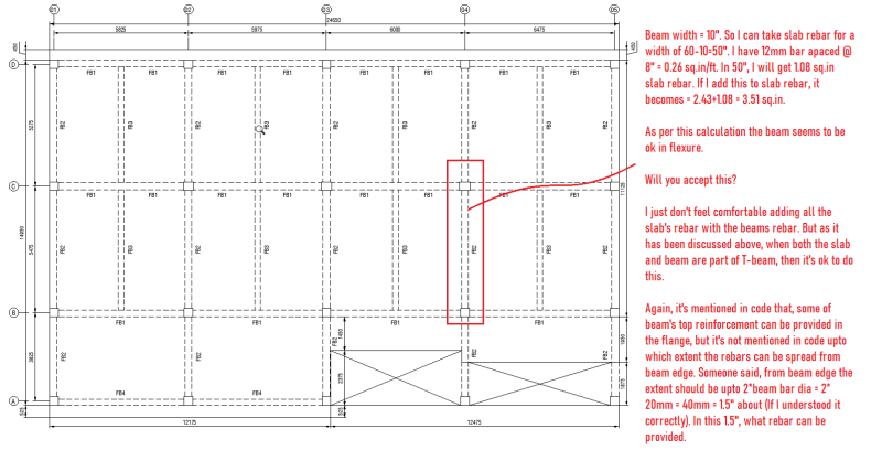

Please see the following figure.
At the marked location of beam, it requires 3.5 sq.in rebar at top. The beam reinforcement is computed considering the nearby slabs won't resist any load effects by it's nending stiffness. Provided reinforcement at that location is 2.43 sq. in.
The effective with of the T-beam is 60".

Oh, but yeah, you can't just arbitrarily take the full slab width as the Tee or anything like that. A limited width defined by code is part of the beam, then everything outside of that is still being designed as a slab. You also still need all the slab reinforcement designed as part of the slab in the area perpendicular to the Tee beam.
Based on the plan view above, the slab doesn’t look like it would need a great amount of top reinforcement within the flange of the T-beams.
Newbie, how are you assessing the amount of steel the slab itself requires?

rapt, I understand the effective flange width. I might have said the effective flange width 60" in the example i gave, which might be in disagreement with the dimensions shown in the drawing. I picked the 60" just for pointing out the issue, i didn't back it with the layout i supplied. Sorry for the problem.
TLHS, Tomfh. Yeah, a limited slab width will contribute. So pls assume that I have taken that limited code specified slab width in the calculation shown above. Now is the approach i have shown above correct? Thanks.

What would you do in this regard? In new design, I wouldn't consider T-beam action, just rectangular beam, and design it that way. and for the slab I would design it following the conventional methods or in the FEM.
But for this particular case where I'm trying to show a beam's capacity adequate (if it is), I'm considering the slab reinforcement (for the specific width as per code)with the beam top reinforcement.

The slab requires about 0.07 sq.in reinf (for hogging momenet), but provided reinf. is 0.26 sq.in. In that case, as per your understaning, 0.2 sq.in surplus reinf. (per ft. of the flange) could be added to the beam reinf.
If the steel is within the flanges then it will contribute to ultimate moment capacity. Personally I would count it if you are checking an existing structure.
However as discussed you should probably check the slab still has sufficient capacity after deducting the area of steel that you allocated to the beam. It will likely be ok, as the slab is so close to the beam in these locations.
