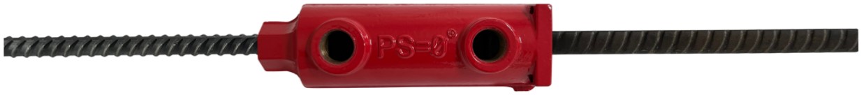

Thanks HTURKAK, but the coupler is not the problem. We know the couplers we're going to use. The question is, can a rebar be anchored by being bolted to a plate bearing externally on the surface of the concrete (rather than traditional methods of bonding over a straight anchorage length, or bearing internally on concrete via hooks, legs, or headed bars)?
The bar needs to be anchored before the future slab (in dotted lines) is cast and there is anything to couple the bar into.
Your approach is complicating the situation and i have never seen such an example. My suggestion would be , prop the first slab and use conventional threaded couplers .
