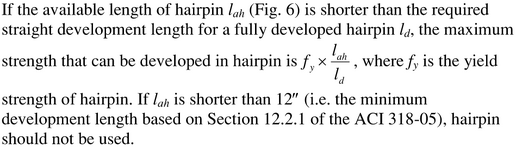

You need to get a development length of the stirrup which is difficult in a pedestal. I always recommend Design of anchor reinforcement in concrete pedestals by Widianto, Patel and Owen as a reference. You can find it online. Below is an except. Or ASCE's Anchorage Design for Petrochemical Facilities is a good reference.
