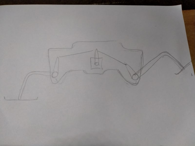

Hi. I've just joined and, well,the technology with foiling yachts is right on the edge of developing technologies, I'm a commercial pilot and designer of an offshore foiling catamaran. This forum will have the mindset for experimental, and concepts, so any interested feedback is most welcome.

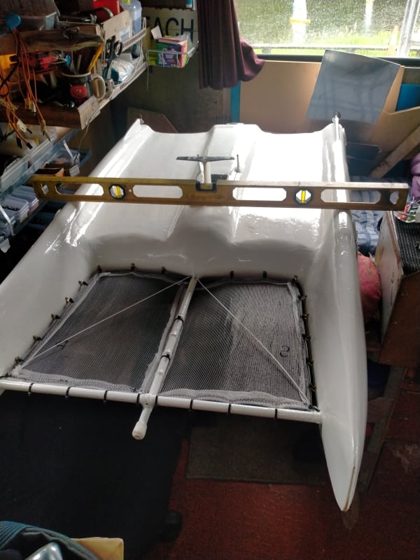

I've built a small scale working prototype, but I'm pondering the larger scale design now. The sailing catamaran boat will be approximately 60', 25 ton. Thought I may consider the second prototype to be 1/2 scale. Just for practical construction reasons, proof of concept etc. The area I'm concentrating on at the moment is the canting foils deployment. Much like AC75 America cup boat has. However my design is not for racing, where hydraulic systems are probably stripped down after every race, but more long term offshore cruising. Tacks will be of long duration, and the load on the foil(s), 2 x on starboard, 2 x on port side, will be mainly a static load. (I've gone for a canting foil, as I'm trying to maximise the righting moment)... Set the foil position and crank on the sail power, plus twin prop thrust (electric) to help get to foil speed. Once the catamaran is foiling, the loads will reduce, though I think design parameters for around 20 ton load on the individual foil arm would be not out of the question.
I've been looking into hydraulic assist heavy duty steering box type of arrangement. I know they have a worm drive and I want zero backlash in the application. I'd like to turn a big wheel, and the pitman arm, connected to a tie rod to similar lever on the foil arm shaft, will, for example, raise the port rear foil and lower the rear starboard foil. And then there is a way to lock that position.
I thought an engineering forum might be helpful. So, I'll see if there's some helpful information out there? Thank you!

are you thinking of the AC75 foiling legs, or the F50 foiling "center boards" ? I think the latter may be more practical, but hey, it's your idea ! run with it !!
on a "cruiser" boat ... maybe have a small prop to provide power to the hydraulics ? maybe a small outboard, so you can lift it when not needed ??

What are the consequences of various types of failures, either of the hydraulic control system or structural failure of the control surface itself? Rapid capsize?
It's a challenging scenario. Over engineering, redundancy, etc. Like all engineering problems. My question is only about deploying the foils, and if steering box type system is something that has any practical application?

Thanks again Wil. You have bought up the global issues faced. Duly noted. I wish I had a jet lol. and Ed stainless. The Japanese. Good to know. AC75 foil arms weigh about 1 1/2 ton. Multiple laminations of profile cut 20mm cold rolled or equivalent high tensile steel on edge. Then you wrap it up with some prepreg or whatnot. Doesn't sound too challenging.
My original question is about raising and lowering the foils in some kind of creative, artistic steampunk kind of way. A big rusty wheel, a stream whistle, some archaic command to relay to the larboard foilhands....aaaarrgh put ya backs innit ya landlubbers!! I have awards for extreme heavy transport mobilehone design and construction. I have NDA's with NZ top boat builders and naval architects about this catamaran concept. Which is now a working small scale. 40:1 radio controlled (I'm a Commercial pilot I have no interest in radio control toys.. But alas.. :( Give me a good x-plane or msfs SIM any day for IMC flights into unknown countries/fields with a nice glass cockpit) ( the small scale has about 10 servos, rotating mast, traveler. Flight control stabilisation on pitch[ centreboard and rudder foils] and yaw[rudder].. My brain hurts) . They all think my revolutionary stability ideas (undisclosed)are a good idea... Getting back to the original question?? Steering boxes, worm drives etc etc... Any takers??? Cheers

I'm quite attracted to the flying boat step hull, and was considering a clip on fwd of the centreboard, for testing, but I seem to have enough sailplan and twin engine thrust to get to foil speed on a reach.
Also DSS and flight control
have become relatively mainstream in the market in one way or another from small moth, IMOCA, hydrofoil ferry, etc. I don't imagine getting stability under control with be an issue
I personally Hate the AC swinging foils. I think they look as clumsy as ... (insert whatever uncomplimentary word you choose).
Could you stow the idle foil against the non-foiling hull ? would look neater, and from your sketch, maybe not too much of a reach ?
