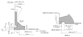

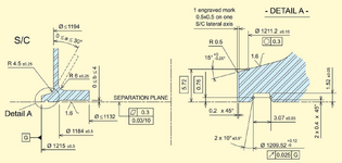

Hello everyone,
I'm new to this site, and I'm hoping to find anyone who has experience with launch adapter rings (LAR) or their installation.
If you can answer any of the questions below, please reply or message me.
  • How common is it for components on the satellite to be located within the inner diameter of the LAR?
  • Are there consistent guidelines for where those components can be located within the LAR on the satellite?
  • How common is it for LARs to be insulated with MLI or foil, and how much of the LAR is guaranteed to be exposed?
  • During installation, are they coated in any lubrication that might still be present in space?
  • Are the LAR's manufactured by launch providers and left to clients to install, or are clients responsible for designing their own LARs that will interlock with the one on the rocket?
  • Is there a way to track which LAR shapes and sizes are in space currently?
Ultimately, this information will be used to help clean up space debris.
All pictures are from publicly available payload user interface guides.
Picture of LAR pair and clamp-band for context:
Cross sections of some sizes of LAR:
    Do you mean "does the satellite fit within the cylinder made by the LAR ?" ... no, how many blistered fairing are there ? (lots) or
    "does the satellite have components that stick down through the LAR separation plane ?" ... don't know, something I'd expect the launch vehicle would define.
    Arh, I think you're focusing on option 2 above. I'd expect these would be controlled by the launch vehicle.
    I'd expect that the LAR would not be covered by foil, as in your example, but this would be controlled by the launch vehicle.
    I'd suspect not, fluids would probably misbehave in space; your example looks like anodised Aluminium.
    Either/Or ... I'd suspect the the launch vehicle would provide the LAR, or alternatively some interface geometry between the launch vehicle and the satellite client. The satellite client may be allowed to install a permanent fixture on the launch vehicle (something that would stay with the launch vehicle after satellite deployment), and build the satellite separation plane somewhere else.
    I think it is unlikely that a launch vehicle manufacturer would want you messing with their structure below some defined geometry.
    But, because your sentence runs on, the satellite will have some interface with the LAR, which I'd've thought would be fixed to the satellite

Thank you, and my apologies for not explaining better earlier. I am designing grippers for a satellite servicer that will grab onto the remnant LARs of other satellites. Once docked, the servicer can take over maneuvering for satellites that are low on fuel or unresponsive, towing them to a better orbit. This is part of a real project my company has been developing over the past few years.
The previous gripper design was developed by another company overseas, but it performed poorly in simulations. As a result, we’re starting over from scratch, including redefining the solution space, as the assumptions and reasoning behind the previous design weren’t well documented. A key challenge in this effort is determining where we can reliably and safely grab a LAR, given the variety of cross-sectional profiles and satellite designs.
From reviewing numerous launch vehicle user guides, I’ve found that internal keep-out zones within LARs are extremely rare. In theory, this suggests payload developers could use the entire internal space up to the separation plane (and often beyond) for thrusters, sensors, or other components, potentially obstructing more favorable grasping features inside. However, I’ve yet to see pictures of actual satellite designs that do so. Interestingly, I have come across two physical prototype LAR grippers from research projects that utilized the inner rim of the LAR, which interacts with actuators during deployment. I’ve tried reaching out to the authors of these projects to understand what gave them the confidence to grab the LAR in this way, but I’ve been unable to get responses from the limited contact information available.
Grabbing only the outer rim is far from ideal, as it protrudes only 10mm and often has minimal clearance (around 50mm). Moreover, I recently learned that molybdenum disulfide dry lubricant is often used during clamp-band installation, which makes friction on this already difficult feature an additional concern.
