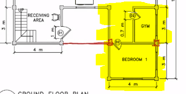

I have this floorplan of my classmate (I was permitted to use for this discussion) which our professor corrected (the red pen) in terms of the proper position of the columns and addition of the beam. He told us for our own convenience, to position the column in a grid pattern and this is a standard when considering an earthquake load. So that is how I asked him about the independent structure in one building.
I wanted to ask how do engineers make it possible that one building, with 2 independent structures makes it look like one whole structure from inside the building?
Same as this floorplan, what if I wanted the highlighted part of the floorplan to be an independent structure so that I do not need to align the columns (like how our professor suggested to do, but at the same time as I walk in the house there is no discontinuity? I am sorry if my question feels like a stubborn one[sadeyes]
Unless there is a need to design this as two buildings, it's too small and I would design it a single building. I dont know what the materials of construction are, but it could be designed in wood, concrete, steel, or CFS.

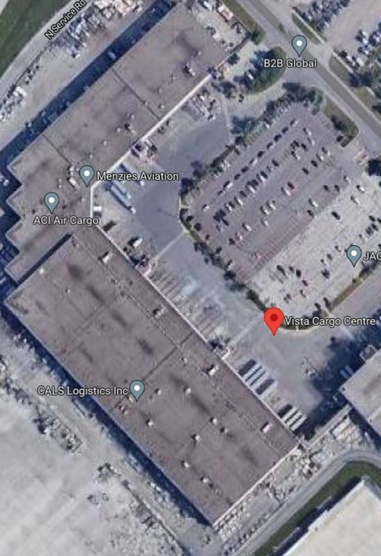

The attached is a building I did years ago. The wide part and the narrow part have a joint at mid length. In addition, the corner part has a joint on each side. The analysis treated them as 5 separate buildings.

There are independent columns and beams on each side of the joints with a clear gap between them. This was 40 years back, but I seem to recall a 2" or 3" (about 50mm) gap between all 'buildings'. The main part of the complex had a 40' clear height, and the front part of the building ('ground side' as opposed to the back part being 'air side') had offices over the loading docks. The joint is handled by a properly detailed expansion joint, secured to one side only. Roofing and structure are independent. If you could move one of the components away from the structure and put it in a field; it would be a safe, stable structure, all by itself. All 5 parts can move independently. The building was the largest (plan area) building I've done. Plastic design (a method of analysis, check with your prof) was used for the structure; it was the first time the company I was working for had used plastic design.

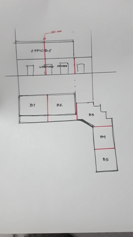

I made a rough sketch of your building. If I am understanding it correctly, the red lines are the 50 mm gap between these 5 structurally independent buildings,and this is where the expansion joints were secured properly.

...a lot less sharp. [pipe] As memory serves, B1 and B2 had 40' clear height and B3, B4 and B5 had 30' clear height. The lower part in front of B1 and B2 is the roof over the offices, and the loading docks were located under the office space. Just a caution, many engineers don't use plastic design... I like it and have been using it for over 50 years, but it is not everyone's cup of tea.

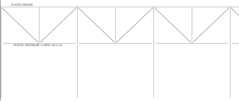

An interesting part of the framing is the structure between the office and storage. I'd seen structure like the attached used for decorative framing at the Eaton's Center in Toronto (non-load bearing). I used the same approach for picking up roof (very high snow accumulation > 100 psf if memory serves and mech equipment weight and snow accum from it) and floor loads for the framing between.
I should have added the plastic moment for the 2 span cont beam on the bottom is 0.0858*q*l^2 and the elastic moment is 0.125*q*l^2... big savings.
