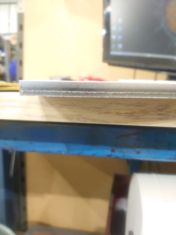

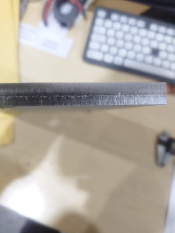

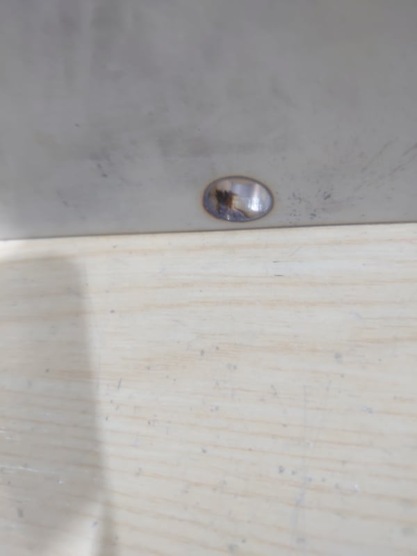

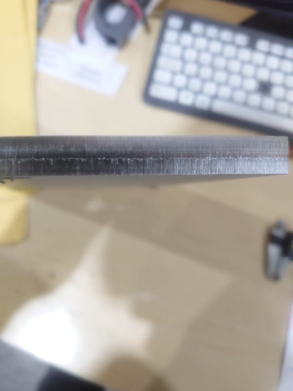

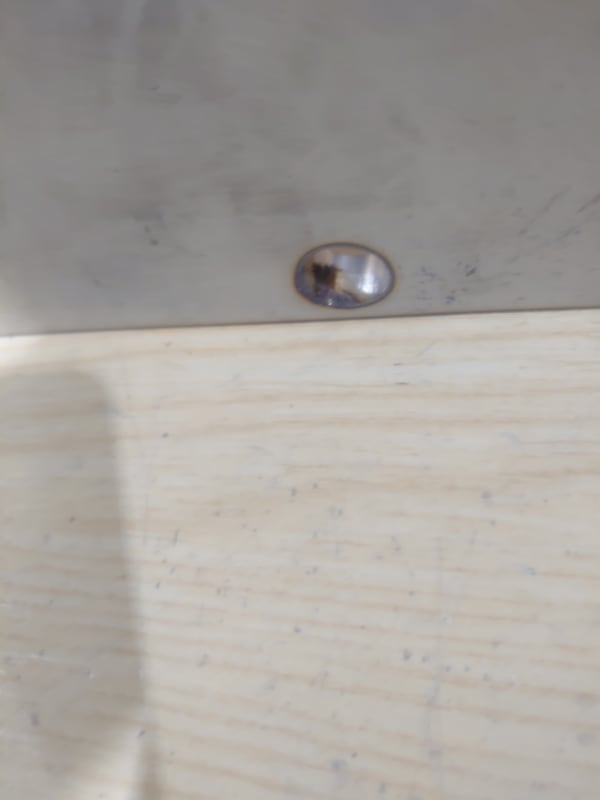

10mm stainless steel I NEED HELP TO IMPROVE CUT!!!
Lucas36
Industrial
Mar 18, 2021
8
GB
Hi! I'm looking for solution how to improve cut on 10mm st/st. Like you can see on the photos top side is perfect but the bottom side is burn. WHAT would you change in cutting condition to looks better? Its use condition 5 for cut holes and 7 to cut shape of part, also after pirce is use condition 2 to start.(photo of cutting condition)
looks like your focus is too deep and your speed is too slow. but a picture of your edge is what i need to see.
Do you have PGC ON? Can you check either page 2 or 3 of your condition screen to see if you have it? If you do have PGC what is the value? What about running the holes with the same condition as the outside?
Yes, the PGC value is 1.
Turn it OFF by replacing it with a 0 and see if the cuts on the holes get better.
no its doesn't help. Any others ideas how to set?
