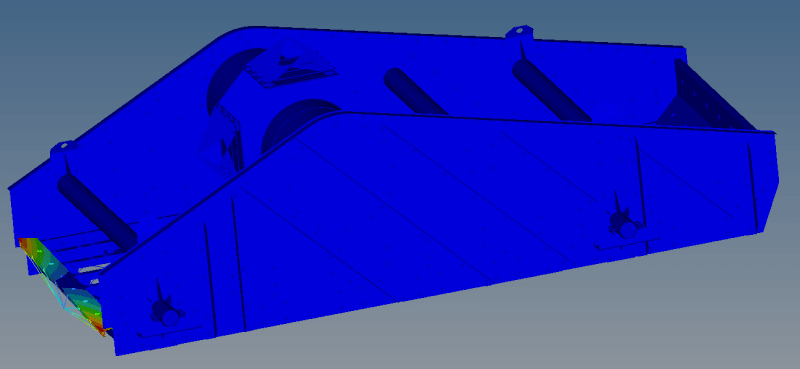

Hello,
I am analyzing a material screening machine. It consists of a structure that is supported by springs. The assembly includes two motors with unbalanced masses that produce an excitation force which causes the structure to vibrate.
The motors operate at 1200 RPM (20 Hz).
As the structure is supported by springs, rigid body modes are present in the modal analysis and in reality. As expected, the effective mass fraction for each of the rigid body modes is near 1.0, with the rest of the modes having an extremely low effective mass fraction.
The modal analysis indicates modes at (or near) 40 Hz, 60 Hz, 80 Hz, 100 Hz. As these are multiples of the operating frequency, I am concerned. I'm sure that if I extract more modes I'll find many more multiples of the operating frequency. But how many modes are significant when the effective mass is dominated by the rigid body modes?
Should I artificially constrain the model? That will change the natural frequencies. How do I deal with that?
I am also concerned that while only a very small fraction of the total mass participates in a particular mode, it may be due to small component vibrating violently and increasing the stresses in the welds that attach it to the structure assembly.
I also ran a quasi-static simulation with inertia relief and identified the regions of high stress.
How can I determine if the operating frequency will result in an intolerable increase in stress values?

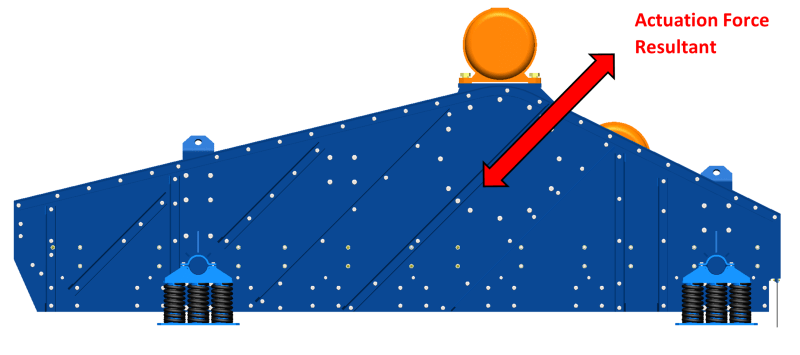

The machine is not rotating. It is vibrating up and down at an angle. See the image below.
I used CBUSH elements to represent the springs. The CBUSH elements have a spring constant in their longitudinal direction only (so only a spring constant is present only in the vertical direction).
Since the structure is essentially unconstrained in the horizontal directions (into and out of the page, and left and right, in the image below), the rigid body modes in those directions are at near-zero frequencies.
The rigid body modes in the vertical direction (bouncing and rocking up and down) are at 3.3 Hz, 4.3 Hz, and 4.7 Hz. Each one of those modes has an effective mode fraction of 0.9-1.0.

@NRP99 This is indeed a shaker and vibrations are indeed intended. The goal is indeed to have the device operate for a set number of years without failing.
My process is to extract the peak stresses per cycle and then calculate the expected life based on the number of cycles that the material can handle at the given stress range. However, the weakest links in the structure are the welds. They are the most likely to fail due to vibration, and they do (either the weld itself fails or the parent material very close to the weld). Since these machines operate continuously and the stresses cycle 20 times per second, they reach millions of cycles in a relatively short period of time. Therefore, I specify that the peak stresses in the welds stay below the theoretical limit for "infinite" life.
My issue is with understanding what happens to the stresses if the operating frequency coincides with some resonant frequencies.
I'll run a quasi-static simulation with the excitation force at it's peak in one direction, and another simulation with the peak force in the opposite direction. The peak stresses (for each region of interest) will form the stress range. For welds, I need this to be in the "infinite" life range.
For example, the quasi-static analysis shows me that the stress crossbeam weld is 24 MPa. That's fine. But the modal analysis tells me that there are modes at 40 Hz, 60 Hz, 80 Hz, etc. So by operating at 20 Hz, the system is exciting these modes. Like pushing a swing every second, third, fourth cycle.
I don't know how to simulate/calculate/extrapolate what will happen to the stresses in that case. What happens to the stresses if the machine operates exactly at a resonant frequency?
Do I need to run a frequency response analysis? How many modes? The rigid body modes take up 100% of the effective mass.

I don't have experience with frequency response analysis. What will it show me? The amplification factors that I can multiply the quasi-static stress results by to estimate the dynamic/resonant stresses?
The material being vibrated varies. Sometimes it's a pile of rocks, where the big rocks keep bouncing to the discharge end of the shaker and the little rocks fall down into a collection bin/conveyor. Other times it's sand that gets washed as it bounces to the discharge end. The material undoubtedly adds dampening and increases the stresses. When I simulate a loaded screen I include distributed masses on the flat bed for the quasi-static analysis where the excitation force is directed up, and no masses when the force is directed down, because the material is loose and not fixed to the structure. I'm open to other ways of doing it, if anyone has suggestions.
I don't know what the internal dampening of the structure is. I don't know what a reasonable estimate would be, or how to include it in my simulation. Surely excluding internal dampening is a conservative simplification that will provide a "worst case" result. No?
So my question remains: If the quasi-static analysis showed a stress of X at a specific location, and the modal analysis showed modes at 40/60/80/100/etc Hz, by how much is stress X amplified when I operate at 20 Hz? And how many of the modes do I need to consider to ensure that I don't miss a relatively small portion of the structure resonating and cracking its welds?
