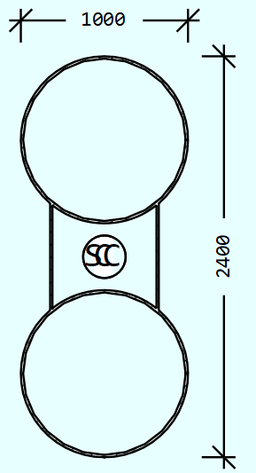

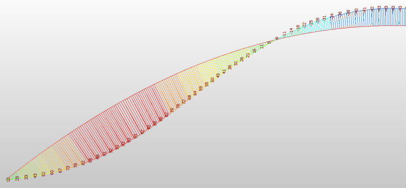

The arch has 96m in span and 19.2m in rise. It has pin support at both ends and is made of steel and concrete.
It has 3 Construction Stages
1. field installation of steel tube
2. put concrete in the bottom steel tube
3. put concrete in the top steel tube
We use Midas Civil, RM Bridge (TDV) and Sofistik to do the construction stage analysis
We will consider time effects, such as creep, shrinkage and E module increasing with time in the furture. But for now, the model is under self-weight only, no time effects.
The boundary conditions are the same for all 3 softwares in all 3 stages, the support is at geometry center of the whole steel tube as shown in the stage 1.
For Midas, we use NonLinear analysis considering Accumulated Stage
Geometric nonlinear analysis is carried out with accumulated effects of the models of each construction stage. This option is used for the forward analysis of a cable stayed bridge considering large displacement.
For RM Bridge, we use “Accumulate Stiffness (Stage) Analysis”
The internal force state (normal forces) of previous construction stages is considered in the p-delta effect calculation. The relevant internal force state must be stored in the specified summation load case.
For Sofistik, we use CSM(Construction Stage Module) Line (Linear analysis) and CSM → TH3 (3rd order geometry nonlinear), both gives very similar results

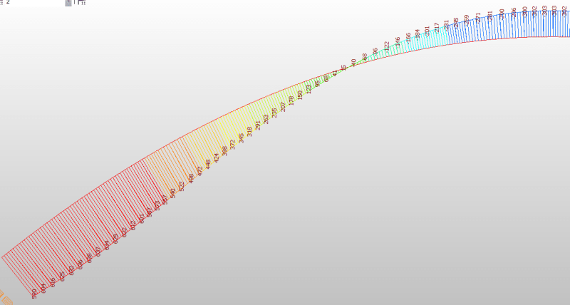

RM Bridge and Sofistik show very similar moments of the arch in all three stages,
while Midas Civil shows similar moments of the arch in the 1st and 2nd stages as those in RM Bridge and Sofistik, but very different moment in the 3rd stage.

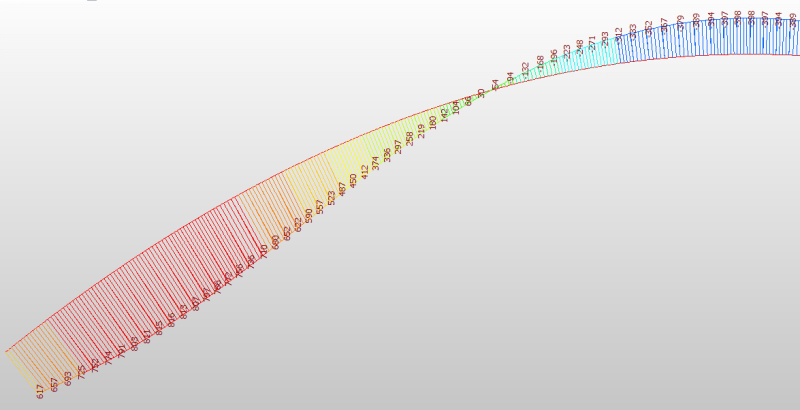

Stage 1 (The moment diagram due to self-weight is symmetrical, so only half of it is hown here)
Midas Civil
RM Bridge
Sofistik
Stage 2
Midas Civil
RM Bridge
Sofistik
Stage 3
Midas Civil
RM Bridge
Sofistik
1. Which result is correct?
2. If Midas is correct, how to fix it in RM Bridge and Sofistik; if RM Bridge and Sofistik are correct, how to fix it in Midas.
The self-weight causes the same load distribution in all three cases. You have what seems to be an arch that is uniformly loaded by its dead weight - the moment diagram will be the same for all three "stages", unless you use props or model "everything" (e.g., shrinkage, temperature variations and so on), which you did not mention.
I also wonder the same thing as "steveh49": are you sure that you´ve applied the correct boundary conditions? There should not exist any bending moment at the pinned support.
PS. This problem (a two-hinged arch, once statically indeterminate) can be solved with the force method and an excel sheet. There is no need to use FEM software, let alone three of them. If you or the client insists on FEA software, you will do just fine with one software package.

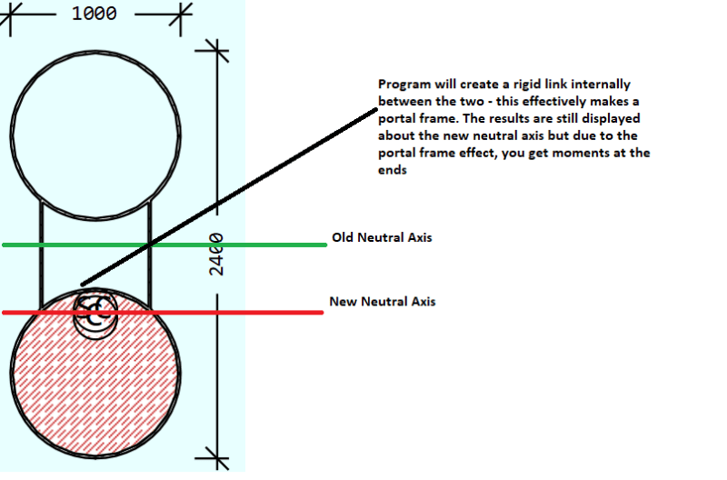

As for moments at the pin supports, I'm not surprised. Your neutral axis has shifted at stage 2 due to the introduction of concrete, but the programs will have kept the support at the original NA location (mid-point of the steel-only section). The programs internally adjust by creating a portal frame with the support at the old axis, your beam at the modified NA, and a rigid link connecting the two:
What interests me is that your moments go back to zero at stage 3 for Sofistik and RM - which shouldn't happen if you're accounting for time dependent properties unless you're looking at a very long time after construction ? (concrete in the upper CHS is younger than the one in the lower CHS - I'd expect the neutral axis to remain somewhere below the section midpoint for a portion of the structure's life after lower CHS has been filled, but slowly move up to the mid point as time passes).
Edit - I noticed that the support moments in Midas Civil actually go up from stage 2 to stage 3. I'd have expected them to go down due to the neutral axis rebalancing effect I described above. Something else might be happening in the background...

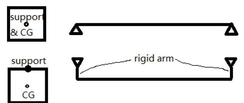

@steveh49, @centondollar
The moment at pin support is due to
1. the distance between support and neutral axis as mentioned by FE_struct1 "Your neutral axis has shifted at stage 2 due to the introduction of concrete, but the programs will have kept the support at the original NA location"
2. the distance between mass center and stiffness center (neutral axis)
@centondollar
The boundary conditions are the same for all 3 softwares in all 3 stages, the support is at geometry center of the whole steel tube as shown in the stage 1, in the pic, C - geometry center, SC - shear center.

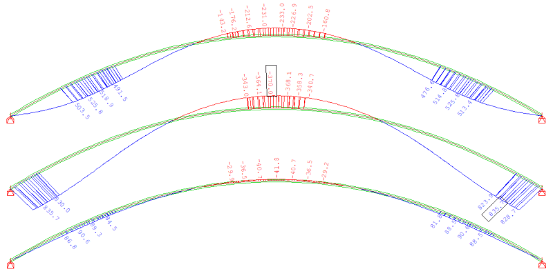

I made some tests. The span of the arch is 96m
Pin support at center of steel tube
1. rise=0, beam structure, the moment at pin support is negative (top in tension)
2. rise=0.1m, the moment at pin support is negative (top in tension)
3. rise=0.2m, the moment at pin support is negative (top in tension)
4. rise=0.5m, the moment at pin support is positive (bottom in tension)
Conclusion: the moment at pin support changes from negative moment to positive moment as rise increases.

As for CS1 and CS2, all 3 software show similar results; but as for CS3, RM Bridge and Sofistik show similar results while Midas shows different result
FE_struct1 and I think the results from RM Bridge and Sofistik are ok, because the moment at pin support soulld be zero at CS3

According to this, only stage 2 should cause moments at the support. In stages 1 and 3, this rigid link isn't used. Midas doesn't change the support moment from stage 2 to stage 3 but the others do. Perhaps Midas is simply adding the results of the three separate analyses while the other two are making some further adjustment for the changing cross section.
These stress resultants need to be handled with care when the section is changing through the analysis. Try running the three stages as separate models rather than staged analysis.

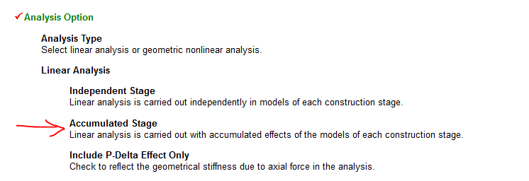

Steveh49 might be on to something. I did a bit of digging and found this buried in midas Civil's docs:
link to relevant page:
netsonicyxf, might be worth checking to see if the accumulated stage option is checked on. If it is, then it explains midas's results.

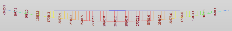

These are the moments w/o stage construction. The bottom one shows steel tube only; the middle one shows concrete put in the bottom tube.
We also tried Linear analysis considering Accumulated Stage, the distribution of moment is the same as that from nonlnear analysis, but the values are very different.

but I'm not clear what the end support conditions are. How can a pin support have a moment?
The end is pin support, it is at center of steel tube in all 3 stages. While at stage 2, the concrete shift the center down, so software will add a rigid arm between center and support.

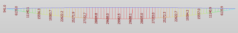

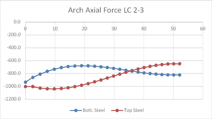

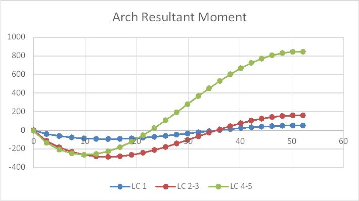

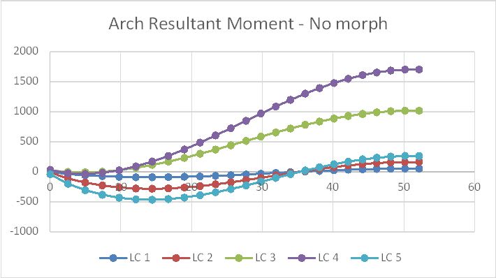

Here are my results:

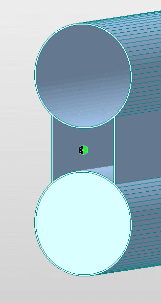

I have modelled the structure as two tubes in their actual location, connected with plate elements. The pinned supports are on the centroid of the combined steel structure, and are connected to the tubes with rigid links. The concrete is added as additional circular elements, overlying the steel tubes:
There are five load case, in three stages:
1. Steel self weight
2. Apply weight of wet concrete in lower tube
3. Connect lower hardened concrete to model
4. Apply weight of wet concrete in upper tube
5. Connect upper hardened concrete to model
Note that load cases 3 and 5 make no difference to the actions and deflections in the structure, because the weight of the concrete has already been applied, but the addition of the concrete in LC 3 does affect the distribution of the loads and deflections in LC 4.
The bending moment diagram below shows the sum of steel tube member moments and axial force x offset from centre line, plus the equivalent actions in the concrete for LC 4-5. Forces in the web are ignored for simplicity for this exercise.

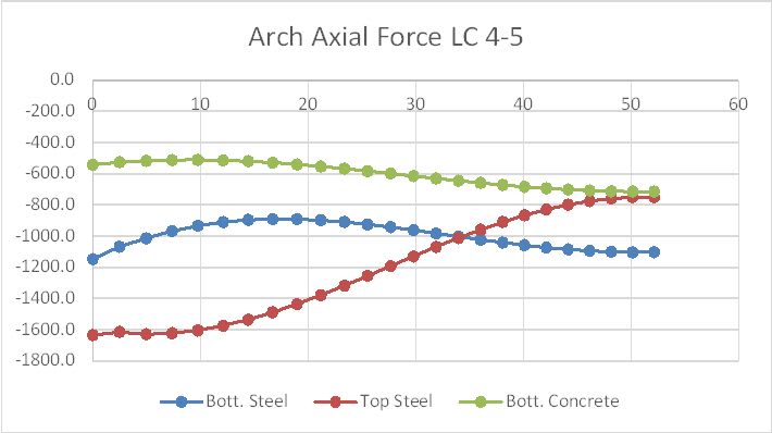

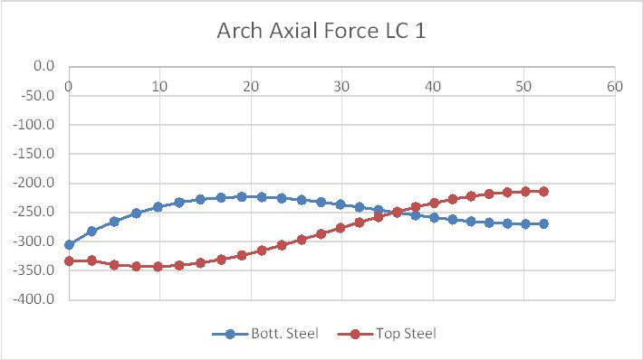

The axial load diagrams show the loads in the two tubes, plus the concrete where applicable:
In summary:
The LC 1 results are reasonably close to the results in the OP.
LC 2 should not have any moment at the support because the load is applied as wet concrete.
LC 3 results are the same as LC 2 because it models the hardening of the concrete, ignoring shrinkage.
My LC 4 results have no moment at the supports, because I have taken moments about the centre line of the steel section, but if you insist on using moments about the section centroid there should be a moment at the supports because the lower tube is filled with hardened concrete and the upper tube isn't.
LC 5 is the same as LC 4 because it only models the hardening of the concrete in the upper tube.
So all three analyses in the OP are wrong for their Stage 2, because they have treated the concrete as having full strength and stiffness. The results for Stage 3 showing zero moment at the supports are wrong because the section is asymmetric about the CL at that stage, and the Midas results are probably wrong as well because they are continuing from the incorrect Stage 2.
