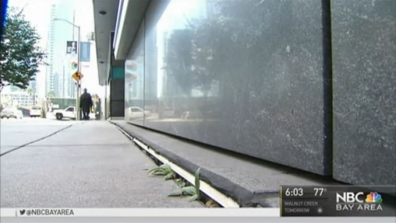

I'm not sure how much basal heave is acceptable but the construction scheme of tying the tower to the shoring wall certainly complicates things. Then there is the uplift of the Mid-Rise on the corner of Mission St. & Beale St., as shown in an NBC image from late 2016. The uplift of the Mid-Rise was just noticeable in Apr 2011 (Google StreetView) and continues slowly over time. It currently looks to be about where it was in 2016.
The tower and the shoring wall are just a large shovel.
If, as it seems to be the case from that photograph, the building is pushing up other structures at one side, it is not so much settling due to accelerated compaction and dewatering of the OBC, as rotating by mobilising the OBC. To my non-local eye words like settlement paint an altogether passive picture of what is going on.
