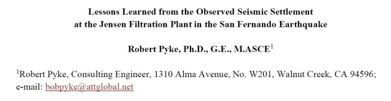

Dik, were you referring to Tim Redmond's conclusion being a bit weak? I assume so. I think that in his third last little paragraph he mixes up Dr. Pyke's position with Mr. Hamburger's. I don't believe that Pyke has opined on what tilt might be acceptable, although I don't know what he said to Redmond. And even Hamburger has said no problem in earthquakes up to a total tilt of 48 inches, not more tilt of 48 inches. And I think he acknowledges that other problems with elevators and plumbing might arise if the tilt exceeds 30 inches. I might add that I am not sure that anyone can calculate what tilt might be acceptable in a major earthquake with any accuracy.
To the article by Robert Pike.
Not being up to snuff with geotechnical and seismic, as an outsider, it appears to be a bit of a 'dog and pony show'.
Dik, maybe, but I think Pyke's stuff was put together more for DBI and the EDRT rather than for the Supes.
dunno, but it does make a little sense.
