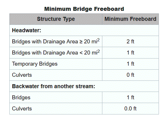

You are not getting results because you are neither using the correct term (called "freeboard") nor asking in the best place ("Bridge Engineering" forum).
This info is from the "Missouri DOT Engineering Policy Guide", Paragraph 7.48.3.5. There are probably alternate recommendations from other agencies that are responsible for bridge design.
Hi SlideRuleEra Climate change influence on the bridges height (freeboard)... not just the normal freeboard. This is a hydrology question which is also used in flooding and storms rather than just a bridge focused question.
Thanks cvg I was looking for something more concrete once again an actual guideline that mentions what you are mentioning.

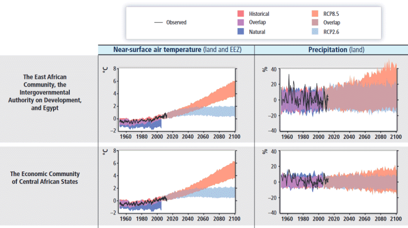

For future engineers in need of information I looked at the statistical climate change of the past years and the closest I could get to Rwanda was Tanzania, Kenya and Uganda's Climate Change report- I attached the report on Kenya.
