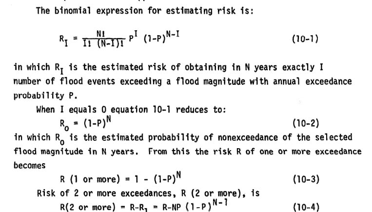

OK I think I found equation.
From bulletin 17B, at
If I followed equation correctly, probabilities are:
30 or more: 1.00
40 or more: 0.98
50 or more: 0.54
55 or more: 0.18
60 or more: 0.02
Make what you will from this, but seems likely you should have 40-55 2-yr storms occurring over a 100-yr period.
CarlB-
Very helpful. You obviously are more brushed up on your statistics than I am. To calculate the values you posted, are you using equation 10-1? I am having a little trouble recreating your results. If I read them correctly, you are saying there is:
100% Risk/Chance (R) of 30 or more events occurring
98% Risk/Chance (R) of 40 or more events occurring
So on and so forth?
Yes I was using equation 10-1. It was a little hard to wrap my mind around. The equation is the chance of that number of events occurring, but you want the number exceeding that, so need to subtract it from 1.
So for example, to determine the chance of 2 or more events, you need to do the calc for I=0 and I=1, add them together, subtract that from 1.
Lends itself to an equation in Excel, row for each year.
And yes, you interpreted my results correctly.
