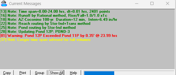

Error 81 im getting Pond 12 is exceeding by Pond 11 by 0.35' @ 23.99hrs. How to resolve this issue I have three ponds connecting one to other.
with two pipe culvert outlets to allow the flow from one to other and third pond is having weir outlet.

[81] Warning: {node} Exceeded Pond x by x.x' @ x.x hrs
At some point during the routing, the node's water surface elevation has exceeded the water surface elevation of an inflowing pond, indicating a possible tailwater dependency. The message shows the maximum amount of reverse head and the time at which it occurred.
Important: The pond routing is not altered by this situation, even though the higher tailwater may in reality cause a reduced discharge. To remedy the situation, select a pond routing method that is able to handle tailwater effects, such as the Dynamic Storage-Indication method.
Also see www.hydrocad.net/tailwater.htm
