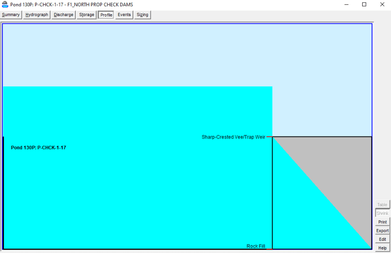

Does this profile view look right to you?
And, under advanced tab of my ponds, would it be correct to set automatic overflow to secondary for my weir
Since you already have a weir to handle the overflow, you should NOT use automatic overflow. These are mutually exclusive.

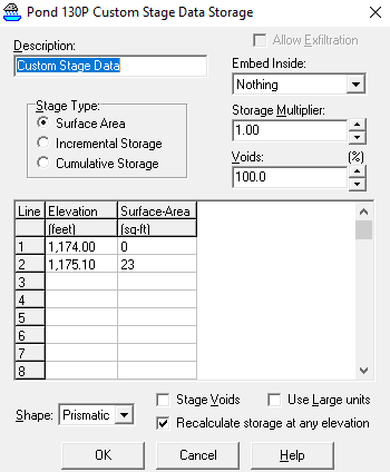

Okay, that makes sense. When I define storage above the crest, am I on the right track to do it as so:
The outlet elevation of my weir is 1175 and my storage goes up to 1175.1
I think if I do this correctly then the storage should span in elevation up until the next check dam.
You need to define the storage up to the maximum WSE, whatever that may be. I suspect it's more than 1/10 foot above the crest.
I assume you have also defined the storage impounded by the check dam? You can generally just add another stage to that storage definition.

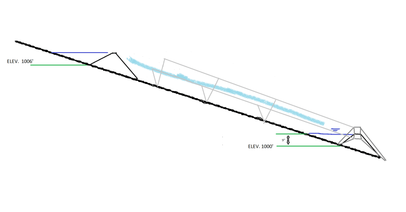

The schematic of my swale and two check dams. The check dam drops to 9" in the center and slopes up to 1.5' at the edges of the swale
When modeling any pond you need to provide complete storage data in order to get an accurate routing. Otherwise you will get get a "storage exceeded" warning and the pond behaves like a closed vault - not what you want with a check-dam.
I would go a foot or so above the crest. It depends how high the water gets. Extra storage data never hurts.
