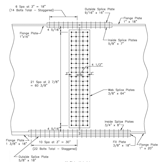

STrctPono, regarding the splices, yes the bridge will likely come in 3 roughly equal length pieces and be spliced together on site before lifting. I would imagine typical bolted splices here. Part of the motivation for varying the flange thickness is to save on weight, which will be critical for the final girder lift.
On further thought, I suppose another possibility is to transition the plate thickness at splice points (where possible), and use filler plates to make up the difference.
Yes. If you do decide to transition the flanges then that is the standard protocol. Something like this....
