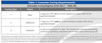

I realize my initial post wasn’t clear enough. My main concern isn’t about temperature control but rather moisture retention. Both CSA A23.1 and ACI 308 specify that curing isn’t just about temperature but also maintaining moisture conditions.
ACI 308 defines curing as "an action taken to maintain moisture and temperature conditions in a freshly placed cementitious material."
CSA A23.1 states that curing must "provide the temperature and moisture conditions for the period of time necessary for concrete to develop its strength, durability, and other properties."
To my understanding, a method of moisture retention is always required for all concrete, even under Type 1 and 2 curing in CSA A23.1. It just doesn’t necessarily have to be wet curing.
If there’s no moisture retention method, isn’t there a risk for concrete performance (even if tests show adequate strength)?

EDIT - Here are a few slides from an ACI course on shoring & re-shoring of high-rise structures that speak to the above. In the final slide the blue line is wet curing, and the green line is dry curing. It's clear then that the impact of curing, all else being equal, has an impact of the modulus of elasticity. However, what you really want to know is if your dry cured modulus in the winter conditions would be similar to what you could get with a water retention method in the summer. Unfortunately, there is no graph or chart or handbook for that determination. Only experience, really. And in my experience this is exactly what you would achieve assuming the workers on-site did not overcook the slab with the salamanders (or overload the early age slab - that is more critical in winter).

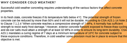

From all the replies, clearly the heating requirements are necessary and not optional in cold-weather. However, moisture retention is not as clear-cut.
The low-temperature heating approach proposed by Enable might work as a form of moisture retention. This could arguably count as “other moisture-retaining methods” as specified by Clause 7.7.2.1 of A23.1-14. However:
  • I have yet to find a single technical document supporting this method explicitly.
  • On-site crews clearly don’t have the knowledge, or the motivation, to fine-tune the heating for moisture retention.
  • Even with good heating below, nothing is done to protect the top surface from large temperature differentials.
Also, looking at high-rise project specs from other firms, all I see is a generic requirement to comply with A23.1, nothing specific about moisture retention in cold-weather concreting.

There is technical literature on rates of evaporation and its impact on concrete curing, just generally not in the cold concrete literature (e.g. you wont find it in ACI 306 or in CIP 27 by NRMCA). I've typically found things of this nature in the Hot Concreting literature (ironically), and usually as they relate to plastic shrinkage rather than drying shrinkage. See here for a good article in Tilt-Up Today on that front.
If you go with the cure & seal route, it is even more important to ensure there are no foul-ups with the heating because it forms a film that traps moisture that'll go ahead and explode (leading to blisters) if the heat is turned off prematurely.
For cold weather concreting you'll most commonly find that insulated curing blankets are recommended. These act as both a thermal cover and as a vapor barrier. That said, there use in mitigating drying is somewhat limited since they do not adhere to the surface and most vapor is transported via air movement rather than diffusion (see Building Science article). Adhered poly is better for this purpose. Also, even if insulated blankets are used, you'll find that the next day they are kicked all over the place since the workers have to move on top of the slab (and they are dangerous to walk on). So for 95% of suspended slabs above grade out there that are placed in the winter, they get no topside protection after 12 - 24 hours (even if specified). If it was a major problem, we would know about it. Of course it very well can be a problem (i've been involved in forensics, and as mentioned in the other thread, I've seen these things happen) but if it was en masse, we would hear about it far more often.
My recommendation would be to place it on the contractor as a means and methods and to verify using in-situ cores. Field cured cylinders will give you a lower-bound, but since they should be located outside of the cure box, they may be more detrimentally affected by the ambient conditions than the slab itself (that has thermal mass). This is part of the reason that ACI 306 does not recommend their use as verification (though, as I said, we use them as a lower bound). Note: you still need cylinders in the cure box down below to be picked up for labs tests the next day.
