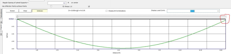

The price they were asking was a little hard to swallow considering they still have non-zero deflections at the end of simply supported beams, a bug that has been around for a long long time.

There are bugs, like the non-zero deflection graph, and then there are outright wrong answers, biaxial bending of concrete columns, when they decided to increase their subscription rate to be near the big dogs like Csi, Bentley, etc. then my tolerance for some of the nonsense got much lower.

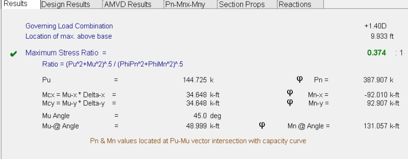

Biaxial CIP Column:
Note the phi-Mn angle is conveniently absent from the GUI.
Applied Mu is at an angle of 45 degrees, resultant capacity phi-Mn is at an angle of -45.27 degrees. So this isn't a solution tolerance bug the result is in the completely wrong quadrant of the capacity surface.
