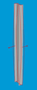

Consider:
1) For buckling to occur, the axial column load has to move closer to the ground. A reduction in potential energy. An end to end shortening of the column.
2) For lateral column buckling, this is easy to visualize. The column takes on a bow shape with significant movement at the middle and the ends get closer together.
3) What form does column shortening take when it's torsional buckling? To generate meaningful, axial shortening, you'd almost have to wind the flanges around the column 360 degrees or something. And the the column web would be fighting this axial shortening. This would take a crap ton of energy to bring about.
4) By the time that you wrapped the flanges 360 or whatever, how much weak axis strain energy have you stored up in the incoming framing that is encouraged to go along for the ride? I would say... lots. Especially if there is a diaphragm present.
The same way. The flanges buckle about their strong axis (the column weak axis), except in a torsional buckle they move in opposite directions, as opposed to a weak axis buckle where both flanges buckle in the same direction. It's takes more energy for them to go in opposite directions compared to a weak axis buckle, due to the extra warping etc, i.e. generally less critical.
Shapes like angles and cruciforms are where it's an issue, as they can torsionally buckle easier than their weak axis buckle mode.

While this mostly answers OP’s question, I’d still like to see it calc’d out by hand…
Would you accept Mastan2? Not really "by hand" but I feel that would be about the right amount of complexity without getting so fancy that important things get lost in the noise.
