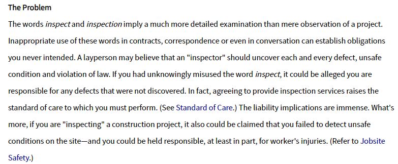

A lawyer once told me not to use the word "inspection", rather, use the word "review"

pham - Review might imply that you ran calcs or checked the area in some other way than visual inspection. I usually use the wording, "in the observed areas", or "it appeared".
GC - XR's post says the lawyer said to use review and NOT to use inspection. I specify 'visual' and use the same wording you have. Maybe I'll check with my broker and see if they care.

Our insurer has many guidelines about the use of the word "inspection." I pasted an excerpt from our insurer guidelines.
XR250, I heard that many times from an old employer and I still follow that guideline. I think the word inspect carries some weight as it might infer that you are certified to inspect certain aspects of construction. I also use the word "observe".
