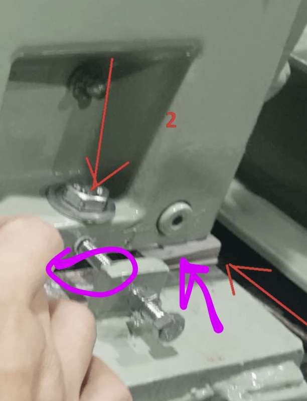

Hi Thanks for the inputs, I attached the alignment photo of the equipment's for better discussion.
Here what is the finding:
1. The Gearbox bolt is not symmetrical in design, shims can only be placed at the back of the gearbox instead from the bolting
2. The vertical alignment of the gearbox is keep jumping as soon as torque down the bolt
3. The laser alignment show the back of the gearbox footing is lower and need to be added by 0.18 and front 0.29 mm, by adding it, it did not bring down my 0.29 mm front footing and make it the front footing more sensitive as soon as the front footing is tighten.

Is it one single 6 mm thick + 1 mm of multiple shims? If not, you have got a spring, which will screw with your alignment.

Those are stiff couplings and are likely carrying some of the weight of the gearbox which is why it moves during tightening. I suggest you leave the couplings disassembled during alignment.
Also, you can place shims on the side at #5 even though the bolts won't pass through them. However, I suspect the bolts are distorting the foundation as the gearbox and foundation are not in contact at the bolts.
All of this is due to design error. The 2nd mounting pad is installed in the wrong location. You really should start by looking in to the feasibility of correcting the design error.

Sorry I did not get your point that I shoupd put the ahim on side at # 5. The 5 is where the shim would support the whole wright of geaebox.
The bolt hole as i said is not symetrical.
I also not getting you 2nd mounting pad is designed in the wrong direction. Which one ?
The mounting pad at the arrow is not where it needs to be under the bolt at circle. You need to cut off and relocate mounting pad for best results.
As it's unlikely that will happen, you can still shim as necessary between the gearbox and the mounting pad at arrow. Expect some movement as you tighten bolts. You may be distorting the gearbox, though. Check your pattern after alignment.

Thanks for the advise, I have moved the shims to the machine bolt and it is easy to align now with coupling on.
