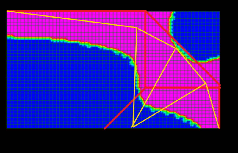

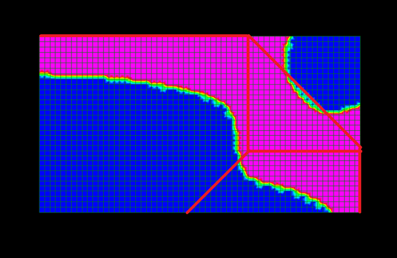

At this point I was satisfied that this would be the critical failure pressure on the bearing pad, but I wanted to confirm this with a nonlinear FE model. The failure mode predicted by the FE model is shown below. The pink regions indicate where the full plastic capacity of the plate has been reached. The limiting pressure appears to be about 10 MPa (roughly 75% of the predicted failure pressure based on the yield line analysis). What is immediately apparent is that the yield lines do not extend to the corner of the plate but gradually turn inwards and meet somewhere in the middle. There is also no obvious yield line in a diagonal direction. In fact much of the region in the middle remains elastic even after relatively large deflection. The FE analysis did not capture the post-peak behaviour because it was a load-controlled analysis. Possibly the peak pressure may have been closer to 11 MPa or so.
My question then is: how could this sort of failure mode be predicted by yield line analysis? I understand that yield line analysis is an upper bound method and therefore is no guarantee that the critical case has been checked; however, when there are potentially limitless failure modes to be checked, how can we be sure that we have selected the correct one? For simple cases like continuous beams, I can see that yield line analysis can be performed with confidence. But with plates, especially with irregular loading or support conditions, it seems that nonlinear FEA is the only way to be sure.

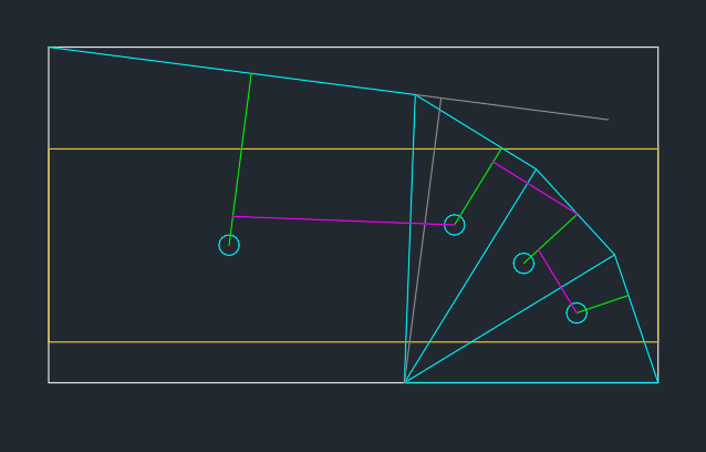

Based on the FE analysis, I wanted to try to replicate the failure mode a bit more closely with the yield line analysis (see below). The main point about the below failure mode is that there are now at least two independent parameters that have to be considered, which makes it much harder to solve as a min/max problem. So I have made a best guess what these dimensions are based on the FE model.
I agree with Flotsam7018 that there is a corner lever effect here, and the model does predict uplift at the corner.
This gives a failure stress of 13.9 MPa, which is slightly greater than the original failure mode I assumed. With some further refinement, I am sure that this could be brought down to below 13.6 MPa, but I have no doubt that it would not get anywhere near the 10 MPa predicted by the FE model.

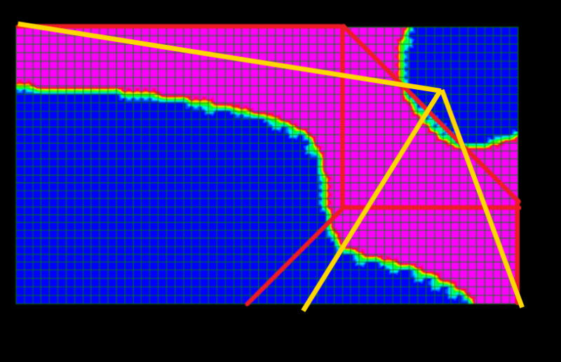

How about this yield line (yellow)?
It's essentially an intermediate state between your original cases 1 and 2.

I believe this is on the right track. I calculate 12.4 MPa for the failure pressure. So far this is the best guess.
12.9 MPa for the above suggestion, still not the best.
At this point the calculation is too tedious. That took around 30 minutes to solve by hand, with the help of a CAD sketch for the geometry.
If I ever get some free time, I think it would be a fun project to automate this, maybe have the ability to drag and drop nodes and yield lines and play around with different possibilities.
