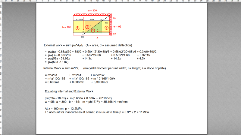

I performed a yield line analysis assuming the pattern shown below, which was similar to yours. I found a pressure of about 11MPa over the bearing pad, considerably smaller than your value of 17.2MPa. I have not given it a rigorous check, so I won't guarantee it at this time, but my calculations are shown below.
My 'x' value turned out to be about 160mm, and it did not seem particularly sensitive to pressure variation with modest changes in the 'x' value.

I have triple checked my original calculations and I still get the same values of x(min) = 164 mm (as you have drawn it) and pcrit = 13.55 MPa.
Note that the 17.2 MPa was for Case 1, which is different to what you have checked.

I can't comment on your calculations, because I haven't seen them. I did not check Mode 1 as it had not occurred to me that it could be critical. Your solution for Mode 2 is 11% greater than mine (before I added the 0.9 factor).
In accordance with Canadian practice, I found the unit moment m to be φZFy = 0.9*25**2*Fy/4 which gave a value of 35,156N-mm per mm. Perhaps the value of φ in Australia is different than 0.9.
Another possible difference is that I did not apply the torsional moment correction at the intersection of the yield line and the free edge to account for the angle being other than a right angle.
In any event, I am satisfied that Yield Line theory gives pretty good results for steel plates. I do not use it for concrete slabs because m is not constant at all locations and in all directions.

Our phi = 0.9, same as you. Only difference is that I did not include a phi factor in my calculation.
So we end up with the same result, which is good to know.

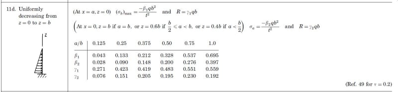

Do you have a copy of Roark's? This case, or a case pretty close to what you have above, is shown on pg 513.
I'd have probably modelled it something similar to:
