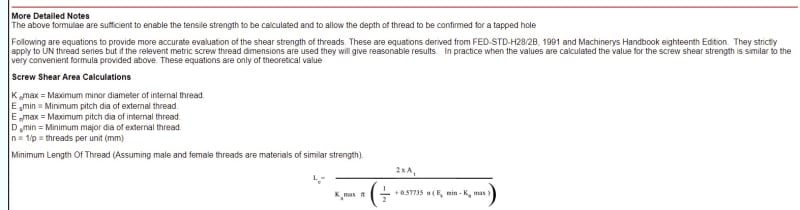

Heres a citation from RoyMech, which i've seen other users here mention as well. Here, the unit is "threads per unit." I think it's inherently confusing to assign a native unit to a variable...
Actually, maybe it does work. Run metric and imperial to check. I thought 0.57735 might be related to threads/inch but it's actually 1/sqrt(3).
I will run it back both ways and compare.
0.57735 is tan30 degrees. Ive seen it written either way some places. Im not sure but it may be related to the threads in some way.
