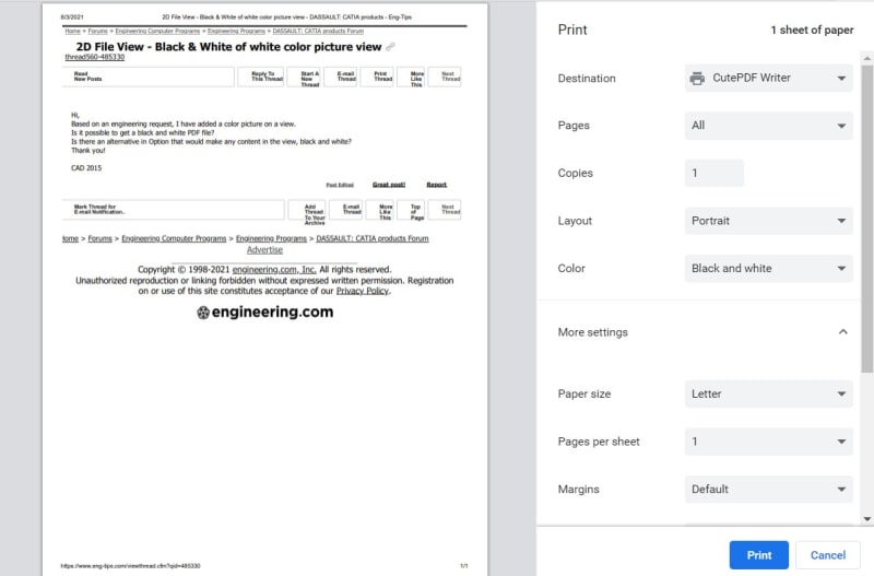

Based on an engineering request, I have added a color picture on a view.
Is it possible to get a black and white PDF file?
Is there an alternative in Option that would make any content in the view, black and white?
Thank you!
CAD 2015
You can "print" the pdf with the optional black and white. What you need, is a "virtual printer" like this one on the right side, at Destination.
You can also insert a black and white picture instead of a color one.
Regards
Fernando
