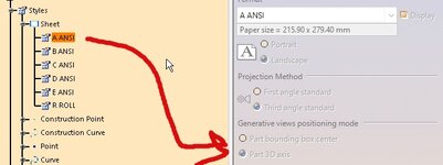

Hi Does anyone know if there's a way to fix the position of a view in the drafting workbench? I'm working on a view showing an assembly, and when I temporarily hide a part of that assembly and then update the 2D, the view moves on the sheet. It is trying to centralize itself every time. Is my only option to modify links to stop this behaviour?
Lock the view before temporarily hide a part of that assembly.......................
From your tree in drafting module. Select sheet and rmb properties of it.
Then there is an option for bounding box or part 3d axis.
Switch it to part 3d axis and you will be good.
↓and if you can modify each sheet in your drafting std, all future drawings will then default to that↓

rickyt thank you very much, that sorted it. All the best
