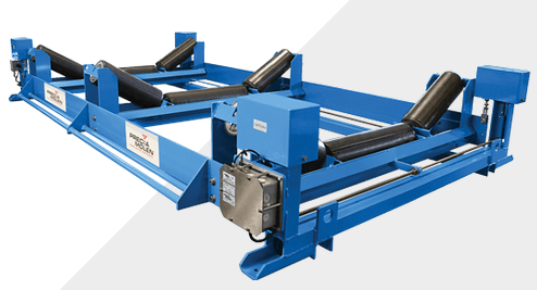

Bagasse coming from the sugar mill passes over several conveyor belts before entering our 2 boilers to be burnt as fuel. The flow is controlled by a PLC and is measured by Precia Molen weighbridge installed on the conveyor using load cells.
Every Sunday when the sugar mill stops, a calibration of the weighbridges can be done. From Monday to Sunday morning, the plant operates 24/24 and no calibration can be done.
We notice that the weighbridge measurement drifts quickly after 1-2 days of calibration. Someone from Precia Molen came on site to check but problem still the same.
On the conveyor belts, there are belts on either side to prevent spillage of bagasse. When these side belts wear, the force they exert on the conveyor belt decreases and this affects the reading of the weighbridge.
Are there are technologies that can be used to measure flow of bagasse on conveyor belts accurately?

In systems that I have seen the side belts did not put any pressure on the main belt, this could be an alignment issue.
Also there should not be constant material against the side belts. If there is constant load against the side belts then you have overloaded the belt or undersized the system.

I think you might have a never solved initial installation problem. Look beyond the weighbridge to things that might affect it's measuring. Bagasse is not an easy material to handle.
Is material sticking to the speed measuring wheel, or the belt?
Is the scale too close to the loading point?
Is the belt tension constant?
Is the weighbridge inclined? Is the incline steep? Can the incline change?
Is the conveyor curved near the scale?
Could there be a problem with the conveyor loader?
If your conveyor uses side belts rather than a single belt folded into a V shape, do they stay synchronized?

No bagasse is sticking to the drum or speed sensor
Scale is not close to loading point. They are in the middle of conveyor belts.
3 conveyor belts are inclined and 1 is horizontal. Precia Molen was aware of all specs at construction stage.

The weighbridge on 3 conveyor belts are used to determine how much bagasse must be fed from the bagasse store; to top up missing bagasse going to boilers from the sugar Mill. The main problem is that a higher set point must be used for a chain conveyor. This have caused bagasse jam in chutes or conveyors, stoppage time.
The weighbridge problem has no direct effect on boiler regulation/operation.
For the time being the humidity content is not the issue. Main issue is weighbridge measurement is drifting quickly 1-2 days after calibration. We must wait next Sunday to do calibration. We cannot stop process to do the calibration or zero. May be a zero may also help to correct the drifting. In the manual it is recommended to do a zero every 24 hrs. This is not possible for us.
One possible cause may be the side belts which prevent spillage. They wear and affect the force exerted on the load cells. So measurement drifts.
When we do the calibration, everything seems ok. We can leave the test weight on the weighbridge and run the conveyor belt to check the cumulative weight for 1 hr. This is also correct.
