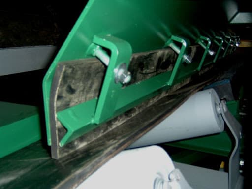

Hi
Bagasse coming from the sugar mill passes over several conveyor belts before entering our 2 boilers to be burnt as fuel. The flow is controlled by a PLC and is measured by Precia Molen weighbridge installed on the conveyor using load cells.
Every Sunday when the sugar mill stops, a calibration of the weighbridges can be done. From Monday to Sunday morning, the plant operates 24/24 and no calibration can be done.
We notice that the weighbridge measurement drifts quickly after 1-2 days of calibration. Someone from Precia Molen came on site to check but problem still the same.
On the conveyor belts, there are belts on either side to prevent spillage of bagasse. When these side belts wear, the force they exert on the conveyor belt decreases and this affects the reading of the weighbridge.
Are there are technologies that can be used to measure flow of bagasse on conveyor belts accurately?
What you show should not have side belts. Is there a picture showing where the side belts are?
All of the belts (side belts and main belt) must run at exactly the same speed or there could be slippage of load material. This would result in the average speed of material on the conveyor being different than the measured speed of the conveyor.
Plz see a picture of side belts on the conveyor to prevent spillage of bagasse. These are fixed and not moving.
The picture above shows what I would have considered these to be sideboards, rather than sidebelts, as they do not move with the belt.
I see lots of possibilities for force to develop between the conveyor and the sideboard. If you are attempting to get close to the published accuracy of the weigh bridge (class 2 of better) the interaction of the sideboards and the belt can be significant.
Not sure if this would fix the problem or make it worse. I would try setting the bottom of the sideboard so that it does not rest on the conveyor belt (a bit more clearance than 1 sheet of paper). Too much gap might create a problem with fibers getting stuck in the gap.

It seems the radiometric sensor may be a solution for us. As wear on the side belts will not affect it contrary to the load cells of the Precia Molen. We have requested quote and we will inform you of the outcome.
