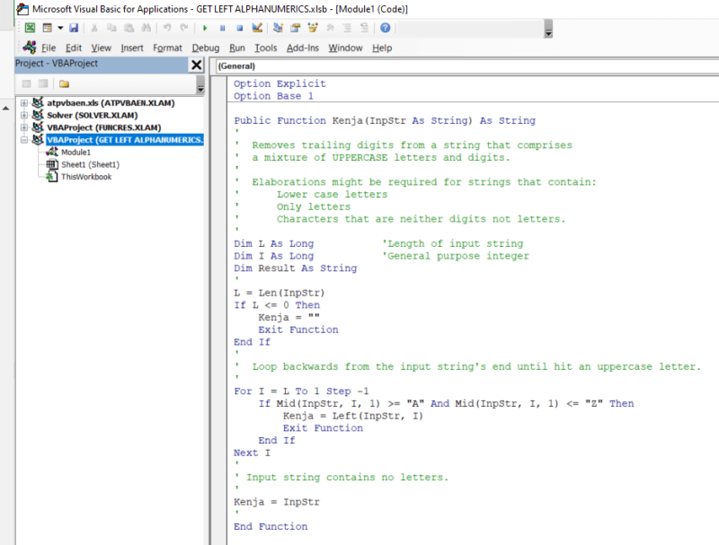

Cell A2 will have numbers with one or two letters mixed in. The letters are always together.
3L481
27H429
9SB75
etc...
In A1 I would like to place a formula that will return the numbers in the beginning along with the letters, but not the numbers after the letters.
3L
27H
9SB
I never know for sure what letters or numbers will be used.
I cant seem to find any examples of this.

This problem is a classic case for VBA, via a User Defined Function.[ ] Dive into it.[ ] You'll open an entire new world.
Couldn't help myself.[ ] Put the following code into a VBA "Module".

Public Function Kenja(InpStr As String) As String
'  Removes trailing digits from a string that comprises
'  a mixture of UPPERCASE letters and digits.
'  Elaborations might be required for strings that contain:
'      Lower case letters
'      Only letters
'      Characters that are neither digits not letters.
Dim L As Long           'Length of input string
Dim I As Long           'General purpose integer
Dim Result As String
L = Len(InpStr)
If L <= 0 Then
    Kenja = ""
    Exit Function
End If
'  Loop backwards from the input string's end until hit an uppercase letter.
For I = L To 1 Step -1
    If Mid(InpStr, I, 1) >= "A" And Mid(InpStr, I, 1) <= "Z" Then
        Kenja = Left(InpStr, I)
        Exit Function
    End If
Next I
' Input string contains no letters.
Kenja = InpStr
End Function

I was going to have a go at the VBA, but as Denial beat me to it, I will just say:
- The "Dim Result as string" is not used so can be deleted (picky, I know)
- I was going to correct it to work with lowercase letters, but I see the comparisons in VBA (and on the spreadsheet) are not case sensitive, so it works with with lowercase as it is.
- For the non VBA lovers out there, to use Denial's code:
Open a new spreadsheet (or an existing one you want to use the function in) and save with a chosen name.
Press Alt-F11 to open the VBA editor.
Right-click on VBAProject(spreadsheet name) in the list of open files on the left, and Insert-Module
Copy Denial's code and paste it in the new module.
That's all.
You can then use the Kenja function, just like any built-in Excel function.
