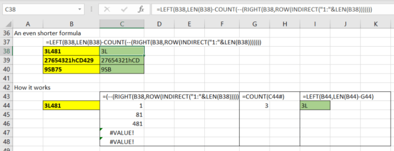

I have extracted the bits of this thread related to the original question in a blog post:
On long and short formulas and VBA
The screenshot below may be of interest:
Thanks to all for everything, even the side-discussions :)

@Doug,
Again, you have rendered an invaluable concise solution that includes an inside-out, step by step
display that demonstrates your design of this excellent solution. Could be a tutorial.
It looks so easy and intuitive when broken down in steps. Of course it doesn't reveal the years
of knowledge and experience to know how to apply and arrange the capabilities of various functions.
Practice, practice, PRACTICE.

@Doug,
Trimmed it down by two functions.
Removed ISNUMBER, substituted double unary for VALUE and substituted COUNT for SUM.
[tt]=LEFT(A7,LEN(A7)-COUNT(--(RIGHT(A7,ROW(INDIRECT("1:"&LEN(A7)))))))[/tt]
Your inside-out display approach helps visualize what's happening in the formula. Thanks!

@3DDave,
Your "Shorter:" works.
However, the step-by-step as per Doug's solution, does NOT work to display the intermediate result.
Not sure what's happening. Undocumented? Undesigned?
Therefore, it is not as understandable as [tt]--(RIGHT(A2,ROW(INDIRECT("1:"&LEN(A23)))))[/tt]
Here you can actually SEE the array result. Much more useful. Much more desirable. Makes more sense.
