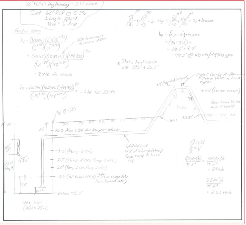

I'm currently working on a pump station design and had a question about the static head and total head of the system. I will be pumping out of a wet well, over a high point in the discharge line as it crosses over a levee, and into a river. The max water surface elevation in my wet well is +5' for my design storm, the levee crown is at +31', and the river stage is a +12.5'. I will have 3 pumps set in parallel with a single discharge line and their floats will be set at different on/off elevations. My wet well will always hold water due to submergence requirements on the submersible pumps down to a -8.5' elevation. An air release/vacuum valve will be installed at the high point in the discharge line and the discharge line will be submerged.
Is my static head the difference in the water surface elevations in my wet well when all pumps are off and the river (12.5'--8.5' = 21')? Or is the static head the difference in the wet well to the high point (31'--8.5' = 39.5')?
Also, to calculate the friction losses in the system should I use the flow rate when all 3 pumps are running or only 1 pump running?
39.5 ft
When using a vacuum breaker, that also breaks siphon action, so you cannot take any benefit from having a siphon to reduce overall head required to 21ft.
If you will run up to 3 pumps, then use the 3 pump flow rate.
You might want to think about a couple of very important options when designing this system. Not using a vacuum breaker valves and selecting at least one VSD controlled pump. That way you could always easily keep the siphons primed by using full RPM head of around 40ft from your VSD pump to start up the siphon action.
After the siphon action was established you could turn down the RPM to produce only the 21ft head from the VSD pump and then you could also presumably design the other two pumps to operate at only the 21ft total head. It would allow you to reduce power consumption by around 50%.
You may need an air release valve if start up flow is insufficient to flush the line of air and you must select pipe that can resist potential collapse from vacuum. I would design for a high enough velocity to flush the air out and eliminate the air release valve. You have three pumps, so I am pretty sure you can do that. IMO air release valves are for long water distribution pipelines that may have stagnant to little water flows in some areas, wnich will allow enough time for air to come out of solution and create air locks. I dont think you need one here.

A profile drawing would help and whether the end is under waster level when it discharge into the river.
Agree you don't need the air release or vacuum valve.
Sorry about that. I'm new to the forum and I think I deleted my previous post by accident. I appreciate all the helpful responses.
I attached a sketch of the proposed system. The end of the discharge pipe will vary from being submerged to unsubmerged depending on the river stage at that time.
The client wants to use a centrifugal submersible pump like they have used on other stations in the area. The pump vendor is saying the pumps function better with the more head they have to pump against. So it might actually benefit me to use the levee crown elevation in my static head calc. On the other pump stations already constructed that have a similar set of conditions, a vacuum/air release combo valve was used at the levee crossing.
The water level in my wet well will also vary but needs at least 7.5' of minimum submergence. I will set this as the all pumps off elevation. Should I use this elevation in my static head calc?
I would ask for a meeting with client and pump vendor's engineer, NO salespeople, to talk specifically about the potential for 50% power savings by using a properly selected pump and VSD controls, on all pumps if you will use all pumps when the river is high. I would suppose yes to that. I believe what sales has told you is, shall we say "not exactly correct". I don't know of any client that would not want to talk about savings of up to 50% on power costs.
Yes, looks like 31'leeve top - 7.5' pump suction = 23.5' head + any adders for elbows and pipe friction.

- The syphon effect will be available only when the down going pipe is entirely filled with liquid (entire cross section). This might not be the case with 1x pump running, having the down going pipe designed for 3x pump running.
- Check the system not only for 3x pump, but also for 1x pump and 2x pump, with the pump curves of the offered pumps. Changes in flow regime and falling away of the syphon effect can have a considerable impact.
- In case you decide to add a "vacuum breaker", which I think is better not to apply, it will have to suck in a lot of air with 3x pump running to break the syphon entirely.
