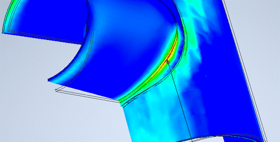

Point for discussion on how best to weld a pipe anchor/trunnion to pipe. As below this could be
1) a set on weld with reinforcing ring on the outside (much like a reinforced tee)
2) full pad welded to the pipe and the anchor welded to the pad.
Fabricators like 2) much easier to make.
As a designer I prefer 1). I can work out an SIF for the stress model and know the pad is not pulling away from the pipe under load. Is there a way to work an SIF for 2)?

I'd use #2. Stronger, due to lack of a hole and far easier to fab.
Full encirclement would pretty much double the pipe stiffness and better distribute the eccentric bending moment the anchor force is likely to introduce into the pipe.

Out our curiosity I looked at FEA for rings and pads. Many geometry variables to consider. This did show;
1. high stress in the trunnion to pad weld
2, if the pad is thin or wide it is not stiff and does not support the trunnion weld. The pad/ring pulls away from the pipe wall.
3. Not a lot of difference in max stress between pad or ring if the pad/ring is stiff.
