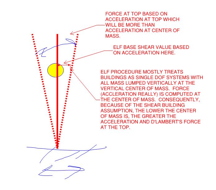

2) Can someone explain to me the reasoning / theory behind the vertical load distribution? re: Eq 12.8-11 & 12.8-12? I've performed a dummy calculation. A two story building with equal heights per story. Equal loads per story. About 2/3 of the seismic load is applied to the roof and 1/3 to the 2nd floor. This changes with different values of k. But how is it that the load from the second floor is now distributed to the roof level?
My line of thinking is that a building over-all is a cantilever. And if we think of a cantilever beam, there is no way that loading the middle of the beam will cause more shear at the free end of a beam. Shear would only effect the beam from the point of load to the fixed end. Yet with seismic, the load in the middle of a cantilever effects the shear at the free end of the beam?
What am I missing?

2) Seismic loading isn't actually a load applied to the building. It's a forced displacement. The foundation moves laterally and/or vertically, and the rest of the building goes along for the ride. To simplify the calculations we have the Equivalent lateral force method. So we approximate loading that would result in a comparable deflected shape. Rather than think of it as something pushing on the building, think of cracking a bull whip. Your hand doesn't move much, but relatively speaking the further out on the whip you go, the more drastic the movement. Same with a building. The earth moves a little at the foundation, but the top of a 15 story building sways a lot by comparison. So a lot of the "equivalent" force is allocated to the top and it decreases as you go down.
It is a cantilever but, by and large, the ELF procedure assumes that it is a cantilever dominated by shear deformation. So attempts to draw analogies with normal cantilevers dominated by flexural deformation can be problematic.
It's not, although that is a very common misconception. Lowering the center of mass of the building results in an amplification of the acceleration at the top of the building and, therefore, the D'Lambert's forces there. It's best to think of this in terms of acceleration as shown below, rather than forces.

OK, I get the whip idea. I suppose that makes sense. But that brings up another question...
1. For a single story building, do I then apply the entire weight of the building at the roof (as an "equivalent" load)? I would think that half of the walls and columns would go to the floor (provided that the load path would normally distribute that way).
2. For a two story building, the w1 would be applied at the 2nd floor and the w2 would be applied at the roof? No consideration for applying anything at the wall levels? That is what the equations seem to be saying. But I would really appreciate a more experienced person verifying this.
Thanks.
By saying I live in R=3, I mean I live in a very low seismic area. With the exception of a couple federal jobs in California that were D, a hospital support building a couple hours away that barely tipped into C, and work in a graduate level Seismic Steel design course, everything I design is SDC B. We also have hurricanes here, so with R=3, the seismic base shear is typically way less than half of the design, horizontal wind load. The only exceptions I can think of are the long, skinny hotels - lateral load parallel to the long face tends to become seismically dominated because the free wind area is really small but the participating mass for ELF calcs doesn't change.
For overstrength - yep, that's about it. I still can't put my hands on my SDM...it's in a box around here somewhere...but if you're using steel not specifically designed for seismic, those items you found are about it. Unless one of the other material codes puts you into it, you don't need to use it. If you're in SDC B, you essentially don't need to use it except at the foundation in a few cases. SDC C still permits R=3, and there are more requirements for diaphragms and collectors, etc. So places where this method is allowed with essentially no overstrength consideration are limited to places where people only understand earthquakes in an abstract sense. We get a little tremor about once a generation or two. We had one about 6 years ago (maybe longer now? I was out of town when it happened)...the Washington Monument's elevator broke, a couple gargoyles fell off of the National Cathedral, and one or two houses near the epicenter shifted a few inches - it seems we only learned about anchor bolts on the east coast in the late 90's (not a joke - my house sits on beams resting on a series of CMU piers with no positive anchorage at all). Was it a "design level" quake? No. But I also didn't hear of any damage reported to steel frame buildings at all. At design level, you'd still have lots of damage but (ideally) no catastrophic collapse. A steel frame, even with R=3, has some ability to absorb that energy through inelastic deformation. The seismic and statistics gurus who decide such things determined that without detailing for it, a frame that meets the requirements of 360 alone can absorb enough to reduce the ELF by a factor 1/3.
No, I do not use overstrength on moment frames when using R=3. Though I will admit I haven't but a tremendous amount of thought into it - as I said before, wind loads around here are often 2 to 4 times the seismic load, depending on the weight of the building. So I sort of have a built in overstrength there when you compare the loads I'm designing the frame for compared to the seismic load.
Regarding vertical distribution, you could probably get away with splitting it and putting the weight of the roof and upper half of the walls and parapets on the roof level and the rest at the ground...but I don't. It's more conservative to put it into the roof and doesn't usually change things too much. If the design starts getting out of hand, I'll back off, but if I get a reasonable design considering all the weight assigned to the roof diaphragm I'll do it. For multistory, I break the mass halfway between the diaphragms. The walls have their own anchorage requirements independent of load calculations for the seismic force resisting system.

- Regarding the reasoning ,theory behind the vertical load distribution? re: Eq 12.8-11 & 12.8-12 12.8.3 Vertical Distribution of Seismic Forces.;
Refer to FEMA 750 ; (....C12.8.3 Vertical Distribution of Seismic Force The deformed shape of the structure of Figure C12.8-3 is a function of the exponent k, which is related to the fundamental period of vibration of the structure. The variation of k with T is illustrated in Figure C12.8-4. The exponent k is intended to approximate the effect of higher modes, which are generally more dominant in structures with a longer fundamental period of vibration....)
- Regarding the Seismic wt calculation , you may follow the following steps,
i- Own weight of a floor and LL's are considered at that floor level,
ii- Own wt of columns and walls in a storey height is distributed equally between lower and upper floors,
iii- The seismic masses are lumped as a single point at the relevant storey..
I hope my respond answers to some of your questions.. Could be tomorrow , i may write for the use of OVERSTRENGTH factor Ωo..
For walls, I believe it common practice to distribute their contributions to both the levels above and the levels below. That's always what I've done. More detailed seismic treatment of the walls themselves mostly comes into play in the design of the attachments between the facade and the framing levels.
