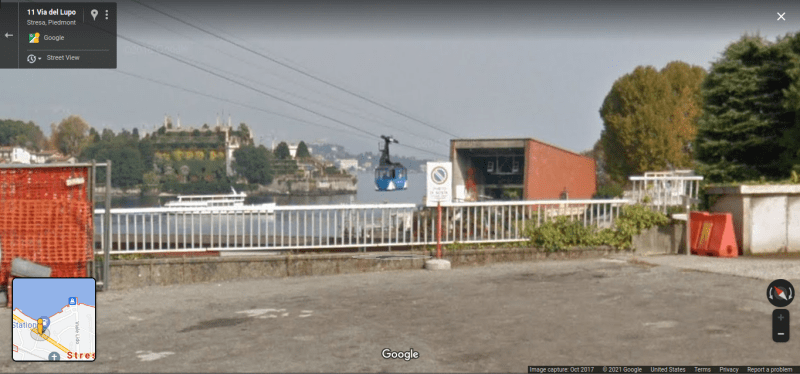

This image shows the cable-way at the Lower terminal, Google Maps Oct 2017.

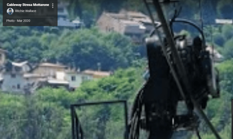

Picture of car - 2019

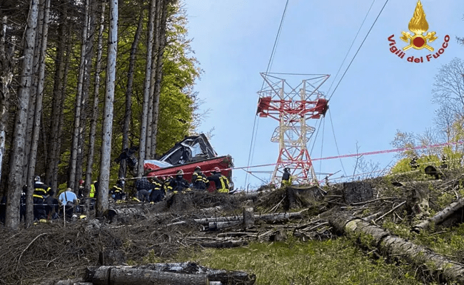

The image at the beginning of the video does seem to indicate a missing cable, if you view further two cables are visible, The smaller safety cable is still attached to the car (at least in one direction). It may have stopped the car from falling all the way down this hill. closer inspection of the video indicates these cables may have been installed by the rescue crew to stabilize the car. There appears to be some cable tangled up in the cable follower, all of the parts of the cable follower that are visible appear to be where they should be, so it is not obvious yet what failed.
These photos make it look like the main cables are still there, but the smaller tow cable has fallen.
That indicates that the cable car fell off the cable. So maybe the tow cable snapped and de railed the car?

The big cables are still there and the eye witness reports state the towing cable broke and the cable car started hurtling down hill until it came to the tower when it came off and then rolled a few times. Must have been horrible to be in.
If you look at the top photo I posted it is pretty clear the thicker cables which the cars sit on is still there.

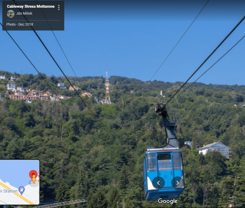

This is what is supposed to be there - one thick cable holding the car, a second thinner one pulling it or lowering it up/down the hill and a third higher cable for comms? or power? from bottom to top.
The top photo I posted shows the thinner lower cable dangling, but the main cable still in place.
