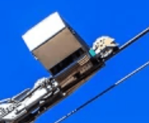

I was thinking the same thing - if you open the image in a new tab and zoom in it looks like two sets of grippers / brake pads for the cable - I can only presume this is the system that didn't work on one of the cars in Italy.
Now you start to wonder how often they test it....
test?
At intermediate supports, are the cables supported from 'little chairs' from the bottom? to allow the 'wheel system' to travel over?
It's not easy to see but I think they get gripped by a number of thin half shell clamps which are only a little bigger diameter than the cable and feathered.
So the car does vibrate a bit as it goes over the cable mounts. Basically the reverse of what happens on a gondola system where the gondola / seat clamp goes over the moving rollers.
