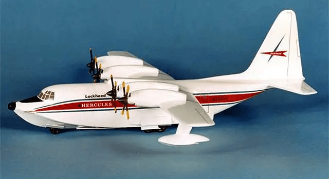

I prefer the 1960's version myself.

The 'problem with floats' is that they are primarily intended for relatively calm water... low swells/chop, like lakes, rivers and protected ocean bays.
The seaplane hull-design dreamed-up 'long ago' is MUCH more suitable for open/rough/high-swell sea operations. But overall rough-sea stresses mean a MUCH tougher/stronger/heavier(?) structure.

At least one of those graphics in the "thedrive" link is from about 2000's I think, so one of those ideas that gets rolled out every 20 years or so. Practically the ramp is going to be pretty useless some 20 ft up in the air. How much margin is there in the vertical stab area, as none of those sketches show additional fin area.

Some years ago Lockheed experimented with an amphibious version of the C130 using a retractable air cushion under the belly. They abandoned the idea after running into directional control problems, particularly in cross wind conditions.
