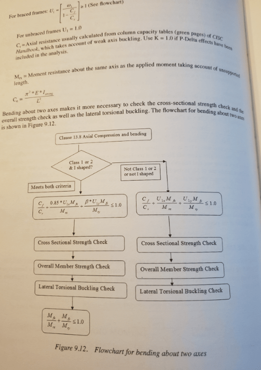

Picture below is your design procedure for combined axial / flexural stresses depending on section class. If you performed calculations based on a more slender section (i.e. designed based on class 3 but actually have a class 2 section) then you can be sure that the design equations for less slender sections would also be satisfied (the other way around quite obviously not). There is nothing else to do in that case as you've just used a less economical member to meet the ULS demand.

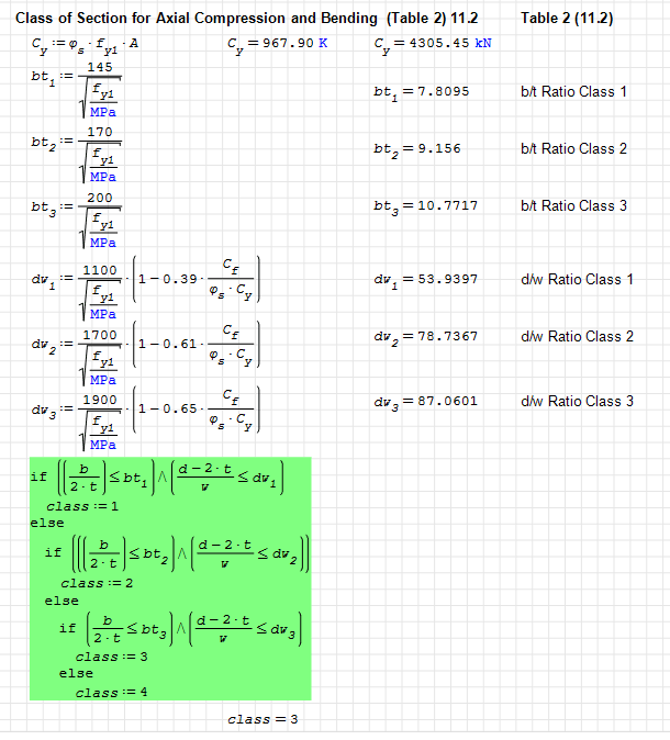

I've never mixed the two... if class 2 and class 3... to me, it's class 3, for everything... The class is a measure of the robustness of the section with class 1 being less likely to suffer from premature local buckling... I'll print part of an SMath program that shows the distinction.
Enable: Is there more to the flow chart you partially printed?

If you look at Table 2 you'll see there are ranges and classes for various ratios for flange and web dimensions for members in flexure. For W-sections the flange limit / class is irrespective of axial loading. Nothing to do with it! As far as a flange check is concerned a beam is a beam is a beam. The web check is another matter. You'll note the presence of axial load modifiers contained within the web class check (1 - 0.39Cf/Phi*Cy) and these are constructed such that they are interpolated between full flexure and full axial.
Here is what I mean:
Axial Only Members
h/t <= 670 / sqrt(Fy)
Flexure Only Members (class 1)
h/w <= 1100 / sqrt(Fy)
Combined Flexure and Axial (class 1)
h/w <= 1100 / sqrt(Fy) * (1 - 0.39Cf/Phi*Cy)
Lets investigate that combined check. What happens if the factored compression force, Cf, is at max capacity for the member?
(1 - 0.39Cf/Phi*Cy) clearly equals 0.61 which if we put back into the combined equation we get
h/w <= 1100 / sqrt(Fy) * 0.61 = 671 / sqrt (Fy)
That's the exact same as the Axial only member (after rounding)!
What if the compression force is 0? Well the multiplier equals just 1 and we get
h/w <= 1100 / sqrt(Fy) * (1 - 0) = 1100 / sqrt(Fy)
The criteria for flexure only!
That's what I mean by linear interpolation between full axial and full flexure. It's already taken into account in that equation set for webs in Table 2.

dik: Not cut-off per se but it does continue to discuss what happens when bending occurs in both axis directions
jayrod: You are correct. Moment capacity is determined by pure flexure equations up in sec 13.5 like the following

Essentially yes, if you go through clause 13.8 it tells you word for word where you need to get the appropriate Cr and Mr from. If you want the beam to remain plastic from the bending, when you determine the MR use the class 3 requirements instead of the class 2.
I'm late to the party, but table 1 is for compression, table 2 is for flexural compression. A beam or column (beam-column to be more correct) in compression and bending is a member in flexural compression, and table 2 applies. A column or brace with pure compression is the only case table 1 applies. You'll never have a member with a different classification in table 1 for compression and table 2 for flexural compression - it's either a column or a beam/beam-column, it can't be both.
That's why I posted the SMath code showing Table 2... I have other SMath programs just for compression.

additional question. what does "with the appropriate class of section" mean? the title is already class 2 or class 1.
Because if you go to 13.8.3 it boots you back to 13.8.2 so you need to be covered for the other classes of sections.
are there different values of "Mr" for the two classes ?
Yes... one using the Elastic Sx (Class 3, 4) and one using the Plastic Zx (Class 1, 2)...
