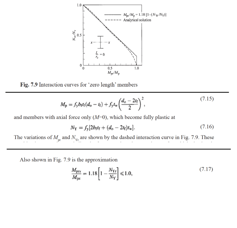

The 1.18 factor (and maybe/probably the 0.85 factor) is an approximation to the plastic section capacity interaction curve determined from first principles for I-sections. See the image below. Since full plasticity in a beam requires infinite curvature (in principle), strain hardening would have commenced before full plasticity but is disregarded on the safe side.

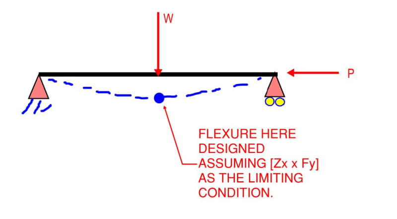

1) Were there to be no beam-column provisions in existence and I found myself forced to fudge my own, I would find it prudent and natural to preclude flexural section plastification in columns with a provision that read something like this:
KOOTK FUDGE CODE: IF [Axial Load > 10% Axial Capacity] THEN [P/A + U x M / Sx < 1.00] END IF
2) Since the CSA provision is not like my proposal, I wonder what is inherent in either the theory or the method to address my concern for flexural section platification in columns. Where is there some possible margin to cover this if indeed it needs covering?

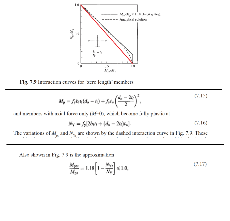

I'll also reboot: the 1.18 factor (and the 0.85 factor IMO) aren't related to strain hardening. They're a slightly unconservative approximation to the plastic interaction diagram. Set axial and minor bending to zero and it leaves you comparing 85% of moment to the design plastic capacity. (I'm assuming that Mrx = design plastic moment capacity in CSA for compact sections).
There's not necessarily margin in the U factor. The term that adjusts for shape of moment diagram is left out for simplicity and this isn't always on the conservative side.

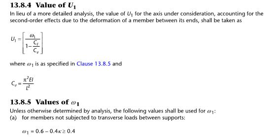

I don't believe that term is left out. It's the w1 term, right?

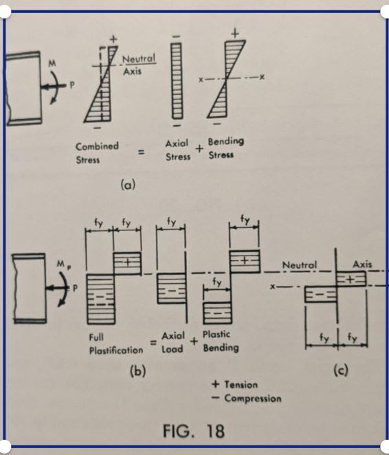

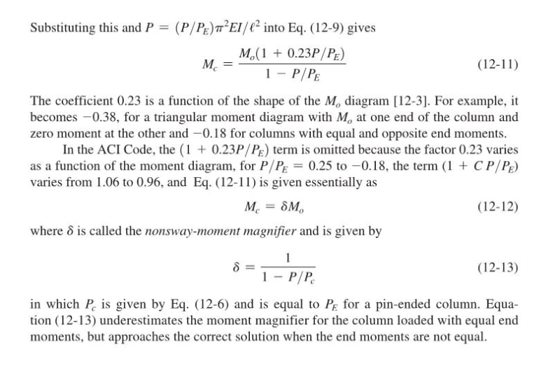

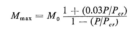

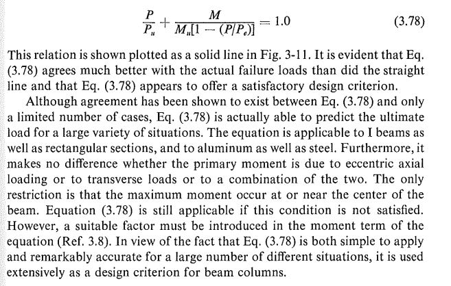

For no reason that general interest, the first three clips below are from Chajes as:
1) The exact solution for a central point load.
2) The exact solution for a uniform load.
3) A description of the method's approximate applicability to broad range of cases with some modification.

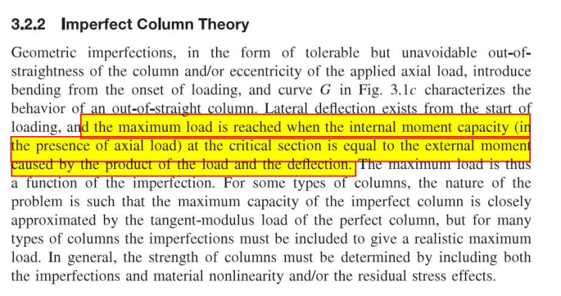

I think the margin comes from buckling not being bifurcation but actually an axial-moment interaction issue exceeding the capacity.
I believe that is also baked into the SSRC column curves that form the basis of general column design. It's not like pure columns of practical proportions typically get to close to their Euler buckling capacity.

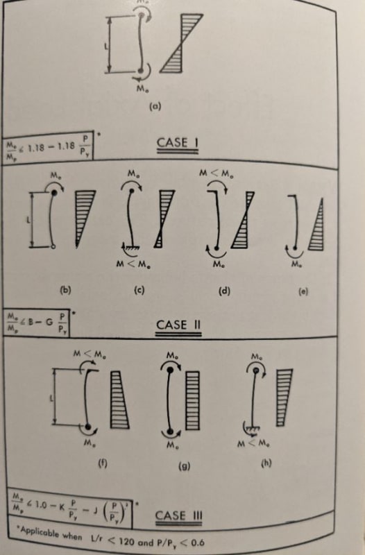

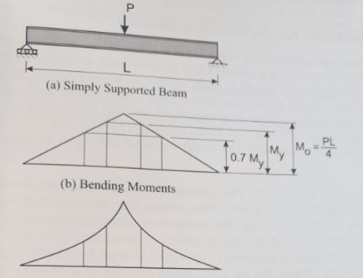

I see it the same. The bottom two clips are from AISC's Plastic Design in Steel The second one shows the assumed stress condition under combined axial and bending at the plastic condition. In the absence of things like strain hardening, I believe that still describes the approach of a plastic hinge as one approaches the capacity.

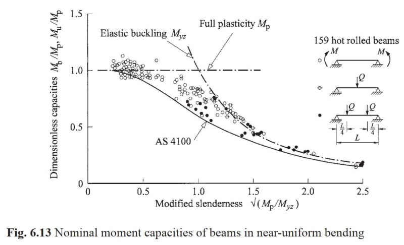

steveh49 said:
The capacity factor keeps you away from the worst of stiffness loss (refer to Enable's image 23 May 21 18:15)
Assuming that you're referring to the sketch below, I agree that would help. But, again, it's non-rigorous help that kind of goes into this bucket of possible stuff that probably does help but nobody seems to come right out and say this was done to prevent flexural hinging in the middle of beam columns. And that is what has been my concern / interest.
I don’t see the case of a beam-column with midspan load plastifying at midspan as particularly different than a simply-supported beam designed to plastic moment capacity (putting aside consequences), or a column designed using the effective length method (accounting for midspan bending moment in a way that hides the bending moment). In both cases, you hit plastic capacity within the span so notionally a mechanism is formed. The load that caused the mechanism is still carried though (or infinitesimally less load actually). It takes additional load to cause a problem.
A more succinct argument is that we have the secant modulus as the effective stiffness for the design load, not the tangent modulus (zero) which would apply to additional load (of which there is none as the ULS load must be an overestimate for the design method to work).

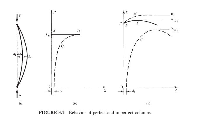

I don't believe that it does take additional load to cause a problem for the case of buckling. All it takes is a perturbation which may or may not be a load. Telling you stuff that I know you know already, one way to see buckling unfolding is like this:
1) Your stiffness with respect to some degree of freedom goes to zero at or below ULS loading.
2) Some perturbation sets the thing in motion. This can be a load, a nominal asymmetry in geometry or material properties, a light breeze etc...
3) The buckling motion itself creates additional moment at the critical location in excess of the amplified ULS load value.
4) I assume that you're referring to the Shanley column model of things. In that context, I believe that the secant modulus allow us to approach the reduced modulus but not zero tangent modulus. A hinge is still a hinge after all and, therefore, a stability problem.
5) I currently view the secant modulus business in combination with strain hardening as the most likely candidate for a meaningful and deliberate attempt to prevent hinging in beam columns. I'm now convinced that there's nothing within the interaction equation to do that job given that:
a) Cf/Cr does nothing in this respect in light of our understanding of the 0.85/1.18 factor.
b) The U & 0.85 factors are often, but not always, conservative. And the impact is often relatively small.

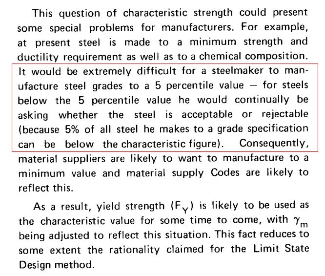

I'm at a loss with this. Perhaps it's some regional difference in perspective when it comes to structural liability. See the two tables below taken from this paper. Based on that, and in the North American context, it seems pretty clear to me that we do in fact consider material understrength and do account for it with a value less than 1.0.
steveh49 said:
the method equates the loads to plastic capacity, and gives tiny factors (that are sometimes unconservative) to allow us to get as close as possible to that plastic limit.
Agreed. I always have to remind myself that organizations like AISC and CISC have a marketing function and constantly strive to be competitive relative to other materials. Heck, I can hardly poke my head in on LinkedIn these days without being spammed to death about how mass timber is the best thing since aerobic life forms.

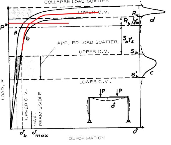

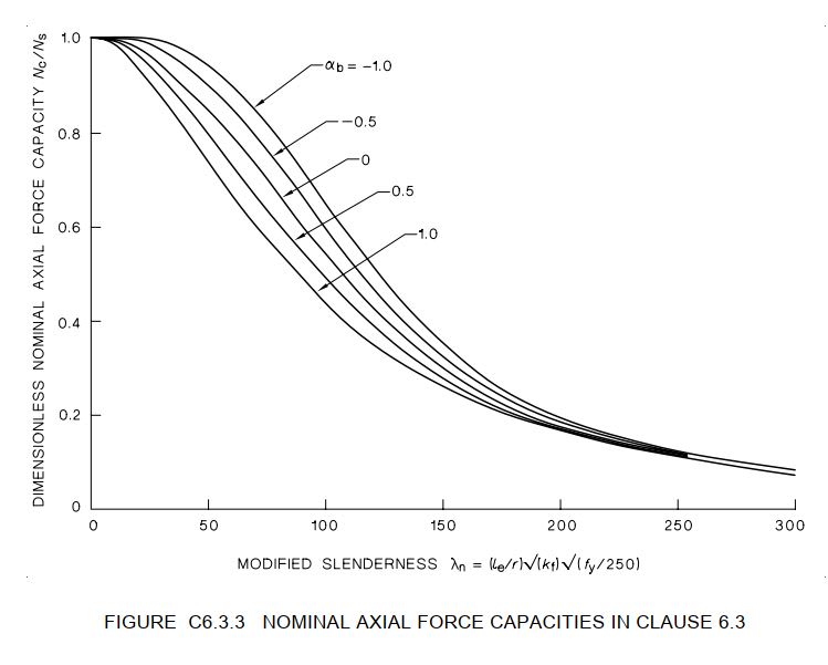

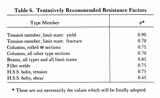

The image below shows where I see ULS loading landing, although sometime above I was thinking of an elastic/perfectly-plastic design model when referring to infinitesimal changes in load. I added the red lines to represent an overestimate of lower-bound capacity due to small code unconservatism; and the resulting unconservative design capacity. The horizontal red line should be compared to the black curve b (the actual capacity).
From the same article:

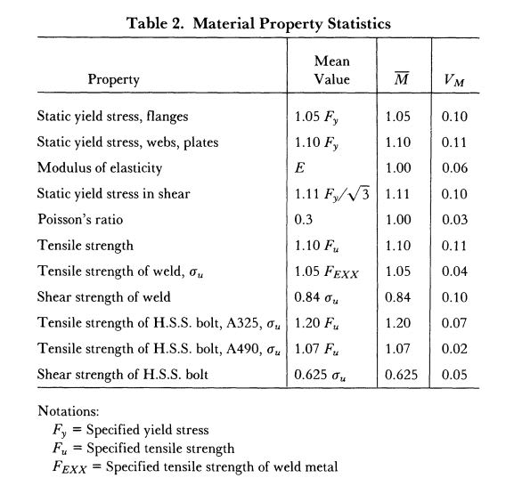

Based on the Galambos numbers for average yield stress and coefficient of variation, are North American steel makers having to deal with this extremely difficult circumstance? Do design engineers approve steel that's 10% under strength?
I take the last paragraph as at least contemplating an increased capacity 'reduction' factor because steel strength doesn't need to be reduced. The Australian code commentary lists material strength as one of five factors that the reduction factor accounts for:

steveh49 said:
If average is 1.05*Fy and the coefficient of variation is 10%, around 33% of samples fail in a normal distribution (?), and a not-negligible proportion would fail by more than the capacity reduction factor. Is that your expectation?
I haven't thought too hard about it but, yeah, something like that. My argument is not that material strengths don't come in reliably high. They do. Rather, my argument is that I don't consider it to be within a particular designer's purview to make use of that fact, disregarding what our standards have to say about it. My impression of how the things work in the steel production world is something like this:
1) The design community establishes material requirements and safety factors based on research etc.
2) The steel production industry reacts to [1] by adjusting their metallurgy so that they are comfortable with the risks involved in their product possibly coming in lower than spec. This surely often means that a supplier's internal specifications exceed those requested of the design community. There may also be other reasons to adjust metallurgy in a manner that would produce over-spec Fy's that have nothing to do with trying to meet Fy.
3) If designers raise their expectations of Fy based on mill certificates etc, producers will probably just return to #2 and create an even more demanding internal spec. In this respect, it kind of becomes a tail chasing exercise.

#3 is accounted for by the perturbation and second-order analysis/moment magnification, combined with the column curve on the capacity side (hidden additional moment). Additional moment in excess of the ULS value requires loading in excess of the ULS load. No argument that things might go pear-shaped at that point.
I still disagree. As you know, North American column curves are based on SSRC curves and the concept of maximum strength as applied to imperfect columns and represented conceptually by path [G] in the diagram below frame the Guide to Stability Design Criteria for Metal Structures. That maximum strength represents a condition of neutral equilibrium between external and internal moments, just as it does in good old Euler buckling. Whether you want to call Pmax or a point on the curve 1% to the right of Pmax the "failure load" is immaterial for practical design purposes: Pmax represent the upper limit of usable column stability.
steveh49 said:
Why doesn't the column curve account for this?
I'm struggling to address that because, unfortunately, I'm baffled by your perspective on this. That said, I know that we were raised on different versions of what "buckling" means and that surely factors in. So, instead of answering your challenge, I'll issue one instead. My perspective:

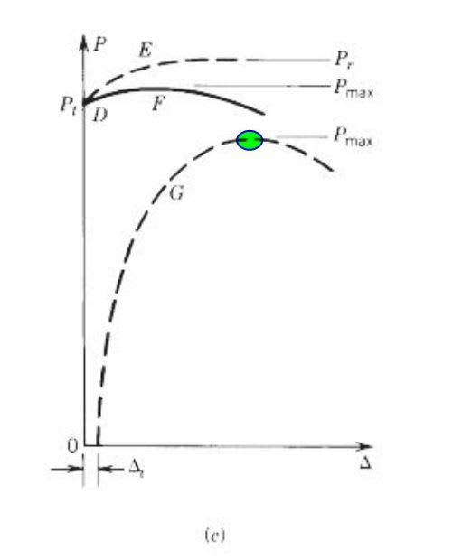

1) The green dot below represents the maximum usable axial capacity of a column as reported on SSRC column curves.
2) While the green dot represents neutral stability, the factored load that would correspond to that is, for all practical purposes the "capacity". Nobody's dead yet but there's no more to be had.
What of that do you disagree with such that you feel more load is required to induce failure beyond that which would take us to the green dot? Me no understando.

Speaking of that, I think that I've rediscovered the source of some of my dogma in that arena (Chajes). This doesn't change anything that we discussed previously of course.
The green dot is the nominal capacity calculated from code column curves. It’s supposed to be a lower characteristic value in limit states design, so ~95% of columns will do better.
We then reduce this by a further ~10% by applying the capacity reduction factor, to account for the various issues I quoted from the Australian code commentary. The capacity has high reliability.
The ULS design loads are specified so that few structures will experience them, and these loads are set to be no more than (green dot minus 10%). Even fewer structures will get to the green dot load level and, of those that do, very few will actually fail at the green dot level.
KootK said:
Nobody’s dead yet but there’s no more to be had.
That’s my position too, but in my view that means you got away with it by the skin of your teeth. There needs to be something (possibly infinitesimal) to push the system over the edge. But it also means that you’re in the perfect storm of severe overload of a statically weak structure, which engineering design doesn’t promise to save you from.
I don’t know about the US/CSA codes, but the Australian codes are pretty strict in the stability stakes. I’ve posted a scatter plot of beam tests vs the Australian code capacity (I don’t have one for columns). It’s the lower characteristic value as expected, before applying the capacity reduction factor.
I’ve also posted our column curves. We have five depending on residual stress level (method of fabrication). In 2011, the US column curve was similar to the -0.5 curve, so we have three weaker curves that are used where warranted.
steveh49 said:
EDIT: My apologies. I thought I could slip the below in before you returned
And my apologies for not seeing your edits until just now. That combined with you later additions, has me believing that we've reached substantial agreement. Thanks for contributing to this one even though it's not your native code. I learned a lot after you jumped in.
