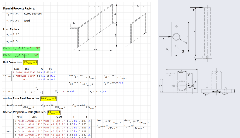

I use platinum Bricscad, but several versions out of date. I was running Bricscad 12 when version 14 came out and I hadn't installed version 13, that I had. I'm not a draftsman and don't use most of the features even the old version has. I use Bricscad for my SMath images converting the *.pdf to *.png using paint.net. It works great... a screenshot of a typical image... The subscripts can be done in the text override as a single string... I use the margin, off the page, to store information I need that won't print... I usually restrict the printed output to a *.pdf of the 'Summary' only and not the entire program. The program may be 15 pages and the summary only 2. If I'm running several different conditions for the same project, I append the *.pdf output to the same file so I may have the output for half a dozen different conditions in the same output. It's not as complicated as it sounds and you get pretty quick at doing it.
