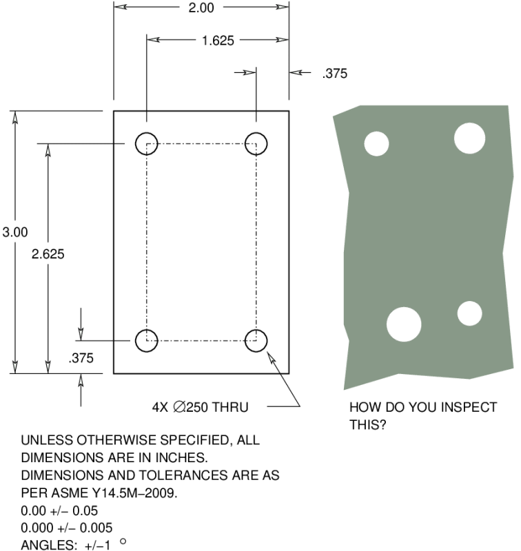

I do not know the policy of ISO. With the ASME Y14.5 standard, my understanding is that they are trying to lose the old plus/minus dimensioning for everything except features of size. If you control plus/minus dimensioning from a note on the drawing, you need to apply a dimension to be controlled by the note. If your hole sits on a centre-line, there is no dimension. You could try writing a note.
Positional tolerancing...
[ul]
[li]...specifies the correct shape of tolerance zone.[/li]
[li]...attaches the locational control of the hole to the specification of the hole. A [±][ ]tolerance attached to the dimension line, controls every hole attached to the line. These could be different holes requiring different tolerances.[/li]
[li]...connects the hole unambiguously to your datum features. The old [±][ ]dimensions can be weird and wonderful.[/li]
[/ul]
This is my illustration of the Wrong Way.
