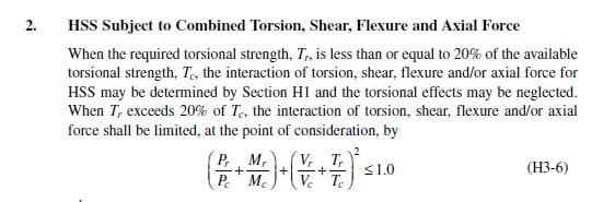

I've got some fairly large pipes under substantial torsion - most examples I've seen of pipes under torsion have ignored the possibility of shear buckling of the pipe under torsion. Can anyone point in the direction of a resource for this? Otherwise I may build a FEA model to convince myself it isn't a possible failure mode with my dimensions, but of course that is only elastic buckling.

H3 of the AISC spec provides torsion design info and they specifically mention the limit states of torsional yielding and torsional buckling. That section also continues on to provide combination formula for torsion, shear, flexure & axial forces.
Years ago I built a spreadsheet around these formuale when I was doing a lot of work w/ monopole signs. And since then I've found that Risa3d does a good job matching my spreadsheet.

I don't know what your pipe diameter (and wall thickness) is.....but if it is outside of the scope of AISC's shapes: be careful. (You said your pipes are "fairly large".)
Of course you have to be careful with anything out of Timoshenko's book as well because there are no safety factors [SFs] suggested. And for a large, thin walled shell.....the initial imperfections and so forth can drive these to be quite high. We are use to SFs on the order of 2-3 to eliminate the possibility of things like LTB, Euler buckling and so on for structural steel......different ball game for thin walled structures. I fall back on ASME code in many cases (including pressure vessel handbooks).

This is on the order of 1.2m diameter for 30mm wall at the thinnest. I'm trying to keep everything within what is called "class 2" in Canada. Essentially, ratio of wall thickness to diameter should allow the plastic moment to develop before local buckling. Alternatively, I would have looked at an elastic model, checked the buckling ratio and tossed on a FS of perhaps 5. In any case, I'll keep things within the realm of being governed by material shear stress (0.6Fy) instead of the buckling capacity from AISC. I'm certainly looking to be quite safe here

At a D/t ratio where you are, the 0.6Fy controls in AISC anyway.
You have to get pretty thin walled for those other Fcr formulas to get below the 0.6Fy ceiling.
