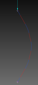

I was playing around with this in a FE software. As an assumption, I modelled the stiffer parts as fully rigid elements. I don't think that would be unreasonable, e.g., for a typical plate with aspect ratio of 5, the relative flexural rigidity is 25x more in the stronger direction.
It turns out that the buckling load can just be calculated based on an effective length equal to the sum of the lengths of the more flexible parts (in this case Lef = 0.5L because the segments are roughly equal). The buckled shape is interesting, the red parts are rigid whereas the blue parts are not.
I suppose if (EI)1 and (EI)2 are a little more similar in magnitude, it would be somewhat more of a complicated situation. Might investigate further if I get bored.
Intuitively it kind of makes sense. The rigid red elements preserve the same slope at the ends of the blue elements, so that when all the blue elements are pieced together, it is equivalent to a strut with length L/2.

from your first analysis (2nd post) it seemed that the flat pieces were critical and the twisted pieces were effectively rigid for buckling about the weak axis.
so if n = 5, 3 pieces will be aligned, and effective L is 60% (or (n+1)/2n if n is odd); if n is even then Leff = 50%
